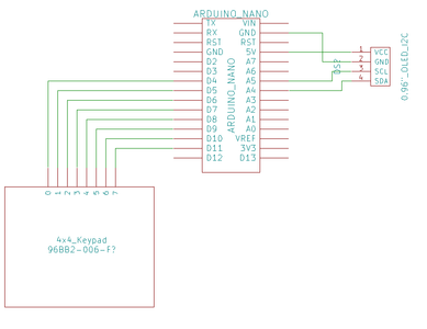

Step 2: Schematic
The schematic is simple: the OLED is connected via I2C, the keypad is connected to 8 digital pins.
