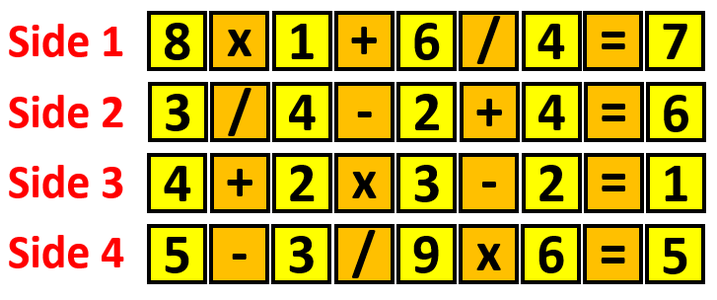

Step 12: Can You Solve It?
The picture shows the puzzle in a random position. Side 1 through Side 4 are the four sides of the block. Since you don't have the puzzle in your hand, you will need to follow this order. If this doesn't make sense, refer to the pictures of the puzzle.
Don't read the comments if you want to try to solve it yourself
