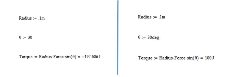

1. Left click beneath Work and type Radius:.1m
2. Left click beneath Radius and type qCtrl+g:30
3. Left click beneath Radius and type Torque:Radius*Force*sin(qCtrl+g)=
4. Left click so that your cursor is just to the right of 30 in θ=30 and type deg
Note: The difference in torque before and after adding deg. This is due to the fact that, computations are in radians by default. When a formula includes a trigonometric function you must specify the unit "deg." Mathcad has a default unit for almost everything so it’s good practice to make sure that the unit Mathcad assigns is actually the unit you intend.
