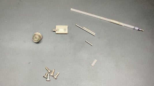

Step 4: Slider Mechanism
The slider mechanism consists of electrical duct casing holding between two 3D printed stands and a slider holding HDD bearing (which is to be attached with rotating circle).
Cut the upper part of the duct casing with the help of mini handsaw as per the dimensions:-
Two pieces of 10mm each
And one piece of 20mm

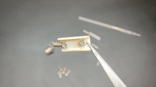

And a small piece attached with a spring.
To make a slider cut a 20mm piece from the upper part of the duct casing and drill a hole at the centre of size as that of the HDD bearing. Also attach a small piece of casing having a spring attached to it.

Now take a thread/string and rolls it on both pulleys and the ends of thread/string attached at the back of the slider spring.
