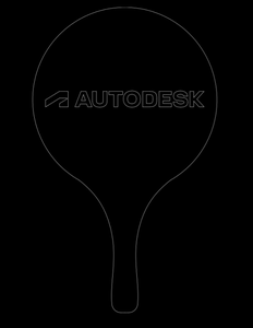

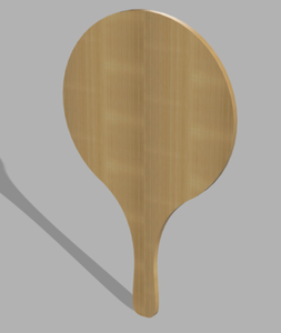

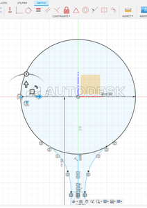

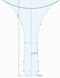

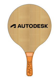

In order to create the paddle, I needed a spherical service with a connected handle piece. To start, I created a 10 inch diameter face to represent the main contact point of the paddle. I then gave myself a 6.5 inch handle length to allow the user plenty of space to hold the paddle. With the intention of rallying, it must be easy for the user to quickly adjust their positioning. With a longer handle, this intention is possible. I rounded the handle rather than keep it flat in order to create some versatility to the grip to allow the user to adjust quickly. The paddle transitions smoothly from the handle to the main contact piece as well.
Next, I utilized Fusion 360's "insert svg" to add the Autodesk Logo into the project. This was important to import into the sketch for the laser engraving. For visual purposes when I started the project, I made it a decal to showcase to my University's Makerspace how I intended to have the paddle look.

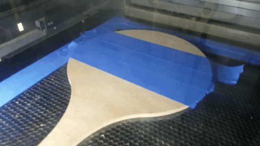

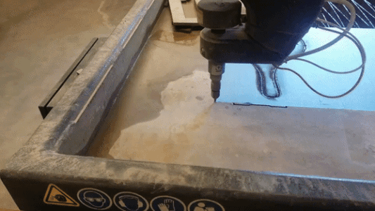

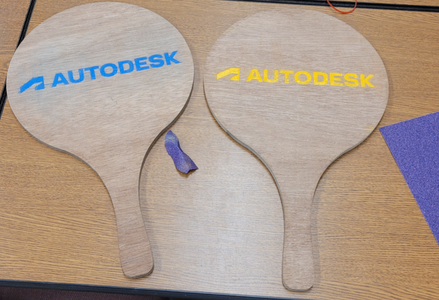

In order to digitally fabricate my paddle, I utilized a water jet and laser cutter. I required the water jet to cut through wood as thick as I chose because the laser cutter would've created a major burn (as you can see with the test paddle). I placed blue tape over the wood in order to easily spray paint into the logo and sand down the product. The blue tape would have no effect on the fabrication either. When using modeling software, I was accustomed to exporting .stl files. However, this was my first time using the .dxf file exportation to create the sketch the software required to produce the paddle. First, I cut the paddle out of my plywood slab using the water jet, then laser engraved the Autodesk Logo onto the paddle.

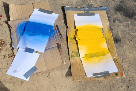

In order to fill the laser engraving to maintain a smooth surface, I coated the paddle with spray paint to fill the indent. I chose my school colors of blue and yellow to provide some school spirit to my paddle. I utilized the blue masking tape on the paddle to fill in the logo, then used paper to cover the rest of the paddle. I then let the paint sit for roughly 6 hours before drying. I sanded down the paddle to prevent any uneven layers to emerge.

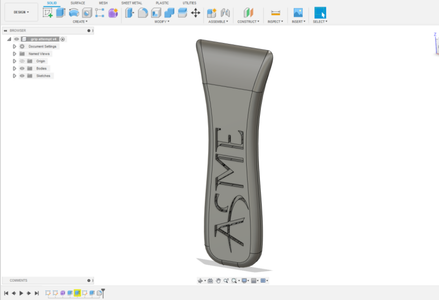

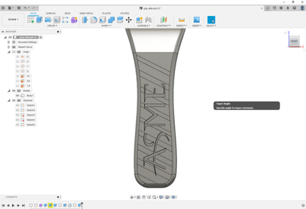

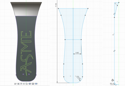

For the grips, I wanted to minimize the costs for filament and reduce the amount required as much as possible. I only ended up using less than $10 worth of filament to create my part despite using stronger HTPLA. I included the ASME font logo to my part using the same "insert svg" command. This time I was able to extrude cut with this feature rather than utilizing it for the sketch.
Additionally, to make sure the part matched the dimensions of the paddle, I actually learned how to transfer the sketch from the paddle to a separate part. This feature within Fusion 360 was helpful tremendously to ensuring my part came out proportional to my previous model.
After a test fitting, I decided to increase the thickness of my grip to give the user a larger surface to hold onto.

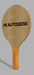

In order to print my grips, I exported my grips as .stl files into Cura to slice the parts. Our club recently purchased two Ender 3 printers and after constructing them my grips were the first parts they printed. I utilized the HTPLA for my grips which came out perfectly with no tolerance issue. I then used epoxy resin to mount my grips to the paddle and held them there for an hour. Each print took roughly two hours to print and I was able to get all my parts done in a day thanks to our club's new print farm!

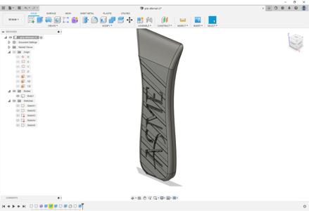

One of the areas I thought about improving the model was the grips. I'm intrigued with trying more surface modeling to create some grip indents to improve the handling of the paddle. I had some initial attempts, but I personally felt they didn't look great with the ASME logo. Further development of my skills with Fusion 360 will allow me to improve upon this design. Additionally, one of my fellow club members recommended I add copper inserts to the paddle, which I think will look intriguing for a design.
