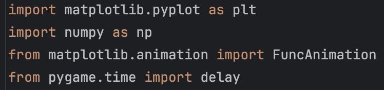

Step 1: Import Libraries
• This code first brings in tools (libraries) to help it draw the animation and handle time delays:
• matplotlib.pyplot is used to draw and display the animation.
• numpy helps with creating random numbers and performing calculations.
• FuncAnimation from matplotlib.animation makes it easy to create animations.
• delay from pygame.time adds a small pause to the animation to make it smoother.
