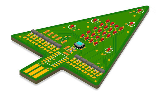

Step 1: The Design
If you are not interested in some details on the schematics and design, you can skip this step.
The challenge was to control a matrix of 20 leds with fewer pins of the microcontroller. This is done by multiplexing the rows of the matrix. In the columns all anodes are connected, in the rows the cathodes. To show a pattern, the rows are switched on and off one after another very fast while the cathodes (columns) of the right leds are switched on. With this, only one led of a column is shining at the same time, so we can place the needed resistor (47R) here.
To control the rows, we need to switch the low-side of the leds. I chose a n-channel mosfet with a very low drain-source-resistance because of the current of up to four leds (~100mA). For the columns (high-side), I chose cheaper p-channel mosfets with a slightly higher resistance, it only carries the current of one led at a time. The decoration leds are switched on the low-side with the good n-channel mosfet.
I chose pull-up and -down resistors with a high value of 100k, because the energy consumption should be as low as possible.
An innovative point of this pcb is the connector for programming, which consists of copper-pads at the trunk of the tree. For more details on this see step 6.
It is very easy to change the shape of the pcb. I designed another round version, like a medal. Get creative here, change the contours and move some components. The code and circuit is the same for every pcb. If you need help with this, leave a comment!

See the attached layout with comments on the placement of each component.

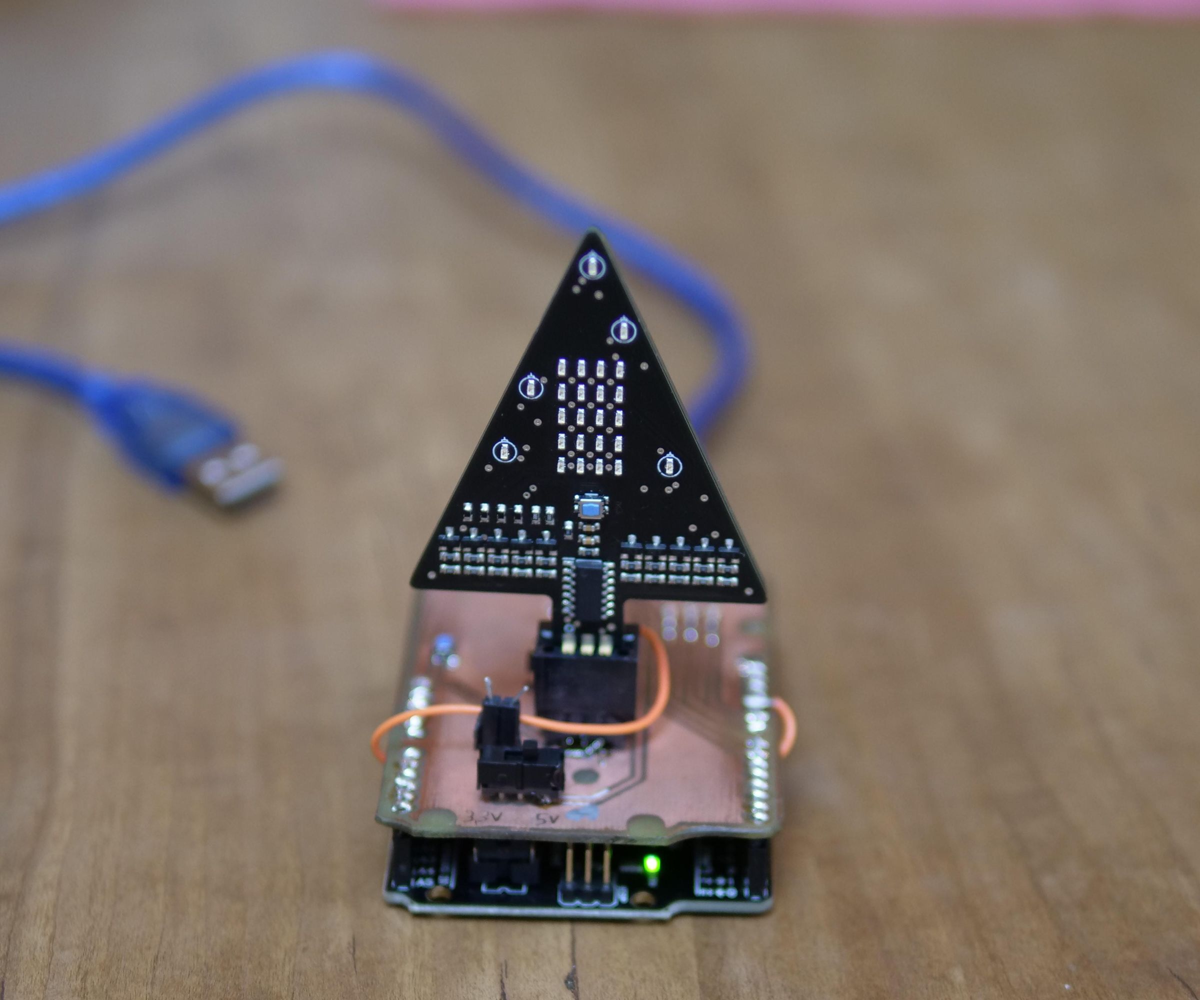

Step 6: Programm It
The cool thing about AVR-Microcontrollers like the Attiny: You can flash them using a standard Arduino so you don't need an expensive programmer. You can learn how it works in the Arduino Reference here.
I wanted to have a clean and tidy pcb witout any connectors for programming on it, additionally I had to program a lot of them but each indiviually. That's why I developed a way to use the trunk of the tree as a connector. I explained in this Instructable how to build and use a expansion board for an Arduino Uno with a 6-pin pcb connector to program any AVR project. I think this a very elegant and practical way for a small series production.
If you don't want to build this expansion board and just have to program few Attinys, you also can solder the six wires to the connector pads and unsolder them afterwards.

  9. Plug your pcb into the programming board
  10. Select the right Port under Tools and upload the sketch
  11. Push the button and check if everything is working
