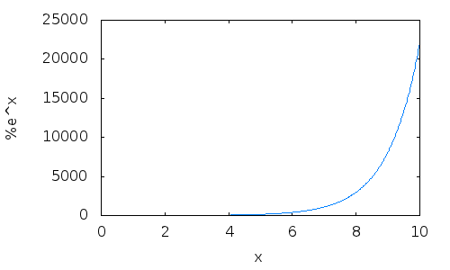

Plotting with logarithmic scale ( %i16 - regular plot, %i17 - with logarithmic scale):
(%i16) wxplot2d(exp(x), [x, 0, 10]);
(%t17) {{expXPlainPlot.png, pic. 2}}   <  %e stands for e >
(%o17)

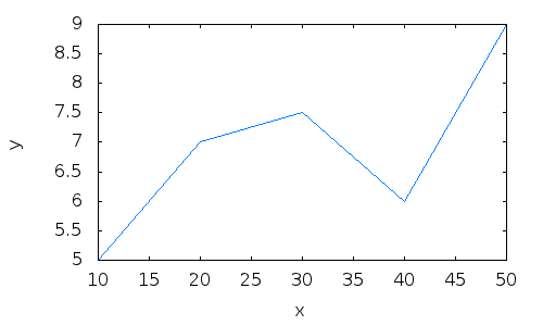

Plotting discrete values:
(%i18) wxplot2d([discrete, [10, 20, 30, 40, 50], [5, 7, 7.5, 6, 9]]);
(%t19) {{discreteValues.png, pic. 4}}
(%o19)

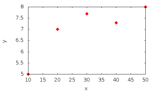

(%i19) wxplot2d([discrete, 10, 5], [20, 7], [30, 7.7], [40, 7.3], [50, 8 ], [style, points], [point_type, diamond], [color, red]);
(%t20) {{discreteValuesPoints.png, pic. 5}}
(%o20)

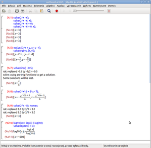

Step 5: Equation Solving
To solve an equation means to find its roots, to express the unknown values in terms of the known values [4].
With the keyword 'solve' Maxima finds a solution to an equation. There are three possibilities:
1) solve(exp, x)
2) solve(exp)
3) solve([eqn1, eqn2, ...], [x1, x2, ...])
With the first possibility Maxima finds a solution to an algebraic equation for variable x. If there is only one variable, the second option is possible. Thirdly Maxima can find the solutions to a system of linear equations.
Some examples illustrate equation solving.
* Linear equations
solve(2*x - 6); or solve(2*x - 6, x); or solve(2*x - 6 = 0); or solve(2*x - 6 = 0, x);
gives
[x=3]
* System of linear equations
eqSys: [2*x + y, x - y - 4];
[y+2*x,-y+x-4]
solve(eqSys, [x, y]);
[[x=4/3,y=-8/3]]
* Trygonometric equations
solve(sin(x) - 0.5);
rat: replaced -0.5 by -1/2 = -0.5
solve: using arc-trig functions to get a solution.
Some solutions will be lost.
[x=%pi/6]
* Quadratic equations
solve(3*x^2 + 5*x - 7);
[x=-(sqrt(109)+5)/6,x=(sqrt(109)-5)/6]
* Exponential equations
solve(2^x - 8), numer;
rat: replaced 3.0 by 3/1 = 3.0
(%o56) [x=3]
* Logarithmic equations:
log10(x) := log(x) / log(10);
solve(log10(x) = 3);
[x=1000]

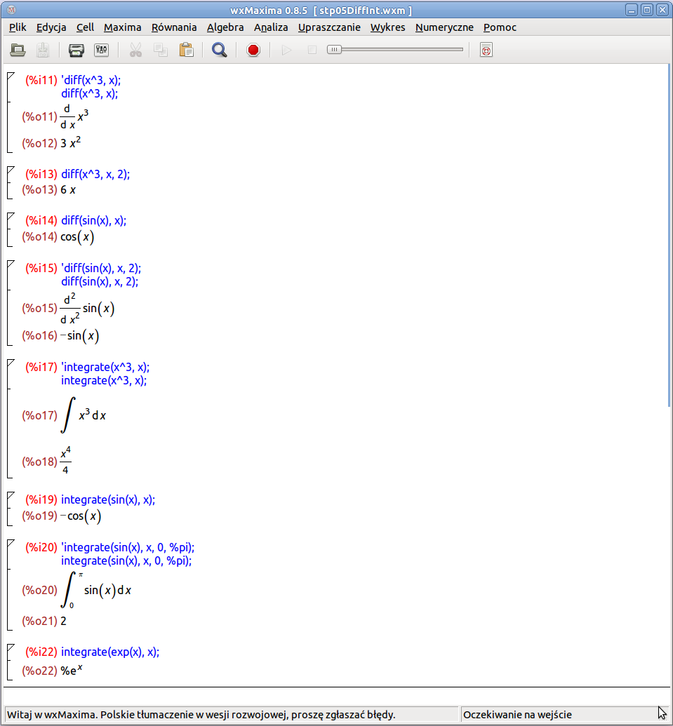

Step 6: Differentiation and Integration
Commands for differentiation and integration are:
diff(<expr> {, <variable> {, <order>}})
where <exp> is the expression to differentiate, <variable> stands for a variable with respect to which the differentiation will be calculated and <order> designates the order of differentiation (<variable> and/or <order> are optional).
integrate(<expr>, <variable>)
Symbolically computes indefinite integral of <exp> with respect to <variable>, and
integrate(<expr>, <variable>, <a>, <b>)
computes definite integral of the <exp> with limits <a> and <b>
Example are in the picture.

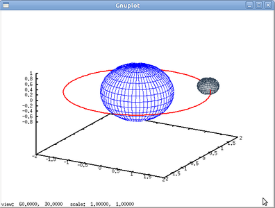

Step 7: 3D Graphs
The capability of drawing 3D plots in CAS applications has always impressed me the most. This is the case concerning wxMaxima as well.
In the following example 3D functions are defined as parametric surfaces, then the plot is drawn with 'draw3d' command (defining functions in separate cells was chosen to preserve clarity, though it is not necessary). The keyword takes as arguments 3 defining functions, the names of parameters, and their limits (parametric_surface(x(u,v),y(u,v),z(u,v),u,u1,u2,v,v1,v2)). The arguments of 'draw3d' keyword are 'nticks' - high value gives smooth graph, 'surface_hide' - when 'true', it suppresses hidden parts, 'color' is self-explanatory, and the variable containing the surface.
The actual plotting can be done in a Gnuplot window, or inside wxMaxima window, with 'draw3d' and 'wxdraw3d' commands, respectively. The Gnuplot window allows for pivoting the graph.
