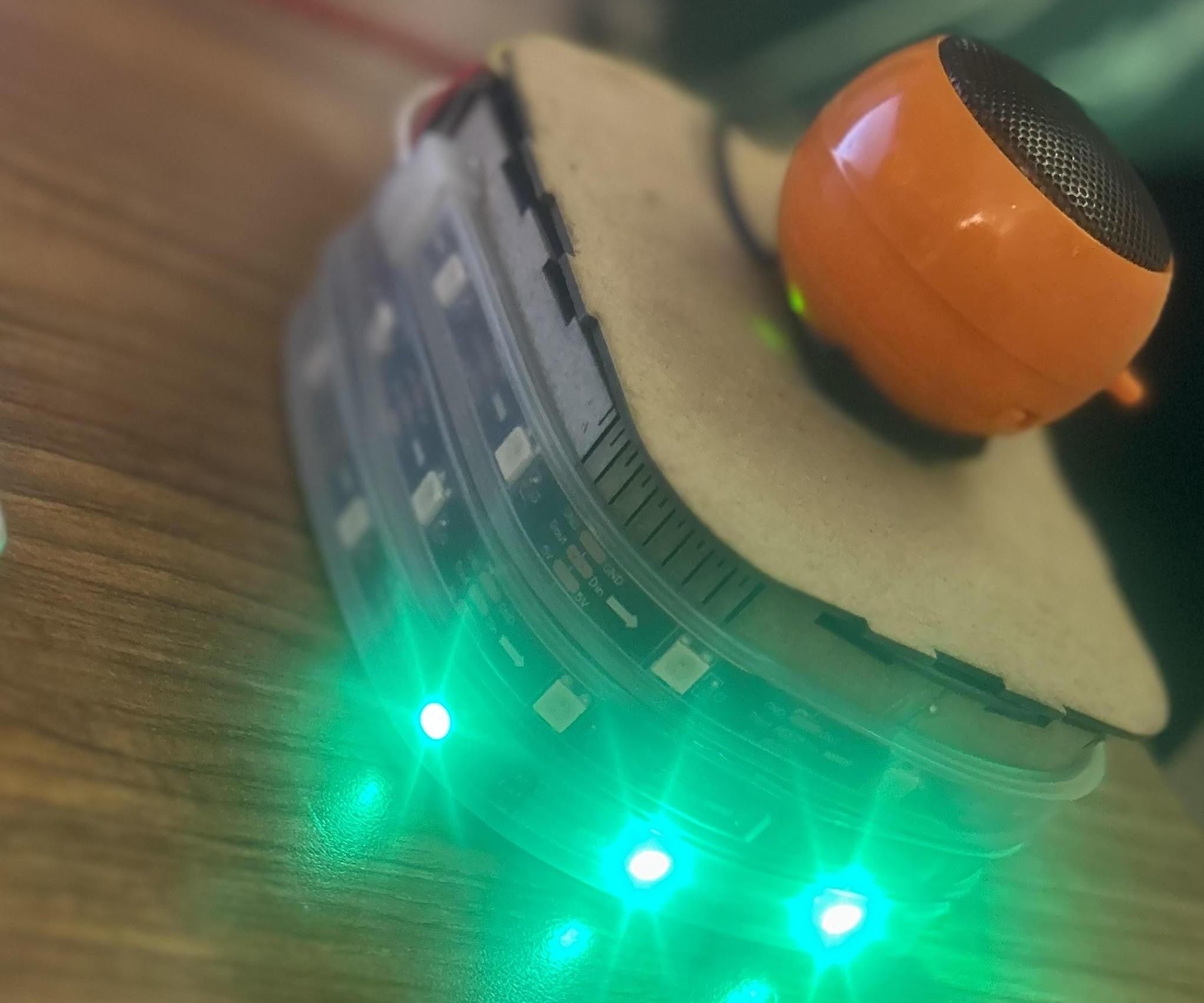

Introduction: Maze Runner Matrix
In this project, we build a dynamic maze game on an 8×32 LED matrix, fully controlled by capacitive touch sensors!
You move a pulsing yellow avatar through a randomly generated maze, avoiding blue obstacles and aiming for the moving green comet border to win! 🌟
The game regenerates with a new maze every time you win or lose, and the border animates around the maze for a clean "living" effect.
This project looks super polished, runs smooth on a Raspberry Pi Pico W, and is coded entirely in CircuitPython.

Step 2: How the Gameplay Works
  1. A random maze is generated each round.
  2. Walls and obstacles are drawn in blue.
  3. The border constantly animates with a slow comet effect in green.
  4. A pulsing yellow dot represents your player.
  5. You move by touching the capacitive pads.
  6. Touching a blue wall or obstacle = lose
  7. Reaching the moving green border = win 🏁
If you lose or win, a new maze is instantly generated.
