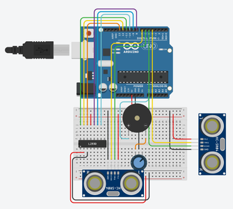

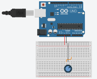

Step 1: Wiring

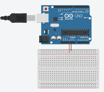

- Begin the wiring process by wiring your breadboard to your Arduino Uno by connecting power and ground wires to each.

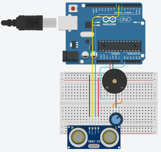

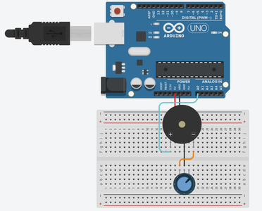

- Next, wire the potentiometer similarly by connecting it to ground and power.
- Connect the speaker by grounding it and connecting it to your desired input on the Arduino Uno.
- Wire both ultrasonic sensors by powering and grounding them and then connecting each of the two inner connections to an input on the Arduino Uno.

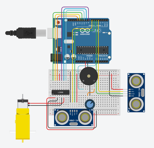

- Now, wire the motor driver by connecting its ground and power then connect all of its inputs and enable port to inputs on the Arduino Uno.

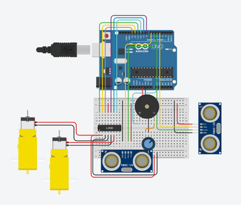

- Finally, connect both motors by simply connecting their power and ground wires to the output ground and power of the motor driver.
Step 2: Construction
- Attach both your breadboard and Arduino Uno to the holding platform. Your wiring should match the wiring shown above.
