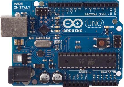

2, Arduino UNO [Amazon]

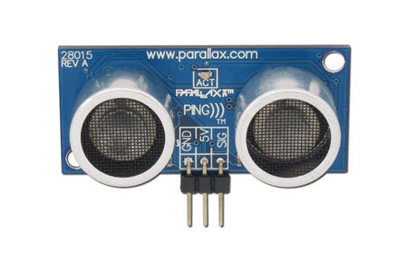

5, Parallax Ping))) ultrasonic sensor ( x 3) [Parallax]

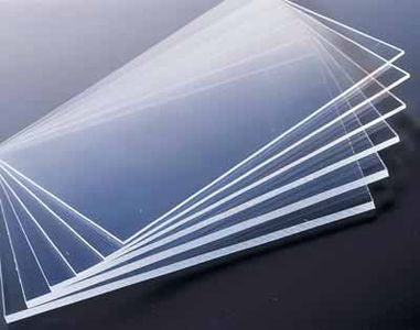

6, 12x12 Acrylic sheet (1/16 in) [ Lowe's]

I use Soldworks to design and cut the Acrylic sheet in order to make more room for the gadgets by creating the robot base, sensor and micro controller mounts.For those who dont have access to a CAD tool such as Solidworks, you can manually do it by cutting the acrylic using any cutting tool as per the given dimensions. For me, I have access to Solidworks and CNC laser cutter, which help me spend less time and less human error. Either way it will work.
PS: I have attached the solidworks part files and a PDF drawing files with measurements for those who wanna manually cut the acrylic. Measurements are in inches unless specified otherwise.
There is an L-backet you need to mount the Ping mount to the base plate. I am not attaching the CAD file for the L-bracket since I made it by manually cutting out from the sheet. In order to get the L shape, I had to heat it then bend it. If you are not careful with the bending, you may not get the bend on the same exact position for the three required pieces, which will make the ping sensors look uneven when mounted. So I cut out a longer square piece then bend it. that way I can make sure the L-brackets are even shaped. You could also buy L-backets off the shelf and use it if you want to avoid the trouble of heating the acrylic.
