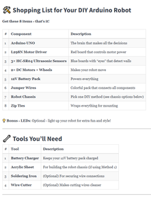

Shopping List for Your DIY Arduino Robot ️
Get these 8 items - that's it!
- Arduino UNO: The brain that makes all the decisions

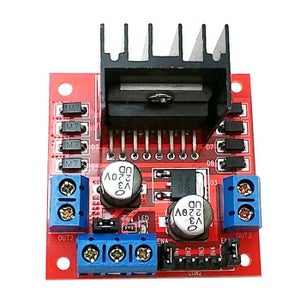

- L298N Motor Driver: Red board that controls motor power
- 3× HC-SR04 Ultrasonic Sensors: Blue boards with "eyes" that detect walls

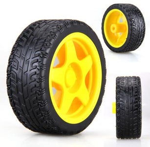

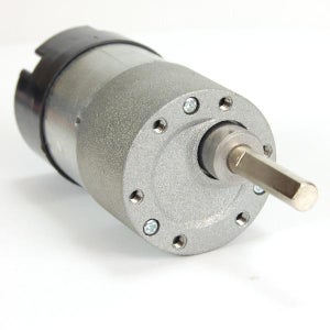

- 2× DC Motors + Wheels: Makes your robot move

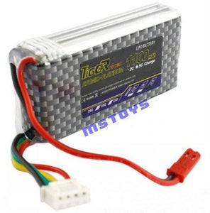

- 12V Battery Pack: Powers everything
- Jumper Wires: Colorful pack that connects all components
- Robot Chassis: Pick one DIY method (see chassis options below)
- Zip Ties: Wraps everything for mounting
Bonus - LEDs: Optional - light up your robot for extra fun and style!
Tools You'll Need

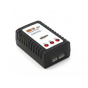

- Battery Charger: Keeps your 12V battery pack charged
- Acrylic Sheet: For building the robot chassis (if using Method 1)
- Soldering Iron: (Optional) For securing wire connections
- Wire Cutter: (Optional) Makes cutting wires cleaner

Motor Driver
The L298N H-bridge: it controls the speed and direction of two DC motors.
it can be used with motors that have a voltage of between 5 and 35V DC.
It also has an on-board 5v regulator (5v Supply), so if your battery voltage is 12v you can use the on-board 5v to supply the sensors or any other parts.
Pins map (Check the drivers picture):
- DC motor 1 “+” > connect this the motor #1
- DC motor 1 “-” > connect this the motor #1
- 12v jumper > keep this connected to enable the 5v regulator.
- Power Source > Connect your battery positive here
- GND > connect this the battery negative
- 5v output (if 12v jumper in place) > connect the sensors here
- DC motor 1 enable jumper > Remove the jumper and connect it to the Arduino this is used to control the speed of motor 1 (match it to the code).
- IN1 Direction Control > connect it to the Arduino this is used to control the direction of motor 1 (match it to the code).
- IN2 Direction Control > connect it to the Arduino this is used to control the direction of motor 1 (match it to the code).
- IN3 Direction Control > connect it to the Arduino this is used to control the direction of motor 2 (match it to the code).
- IN4 Direction Control > connect it to the Arduino this is used to control the direction of motor 2 (match it to the code).
- DC motor 2 enable jumper > Remove the jumper and connect it to the Arduino this is used to control the speed of motor 2 (match it to the code).
- DC motor 2 “+” > connect this the motor #2
- DC motor 2 “-” > connect this the motor #2
Note: This Driver allows only 1A per channel, draining more current will damage the IC. this simply means that each motor should only drain 1A Max.
Battery
I used 12v Battery with 1000 mAh.
The table Above shows the voltage drop when the battery discharges. just keep it in mind and recharge the battery when it drops.
To calculate how much time you have:
Discharge time is the battery capacity (Ah or mAh) divided by the current drained.
Example: for a 1000mAh battery with a load that draws 300mA you have:
1000/300 = 3.3 hours
logically if you drain more current you get less time. just make sure that you don't exceed the Battery Discharge Current Limit or it will be damaged.
