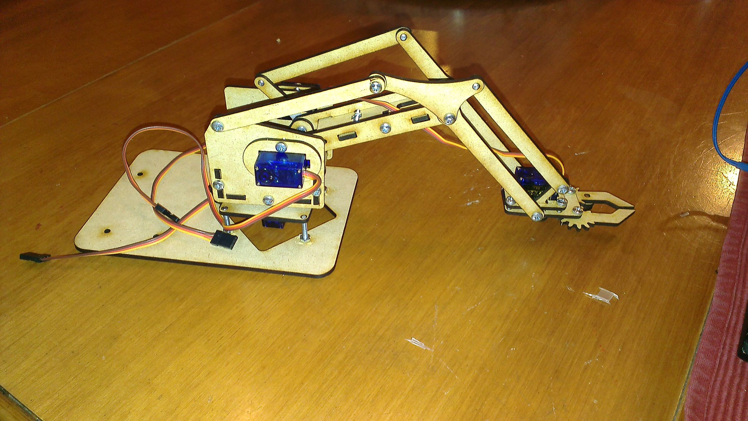

DrPhonon
DrPhonon
7 years ago

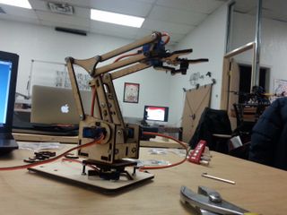

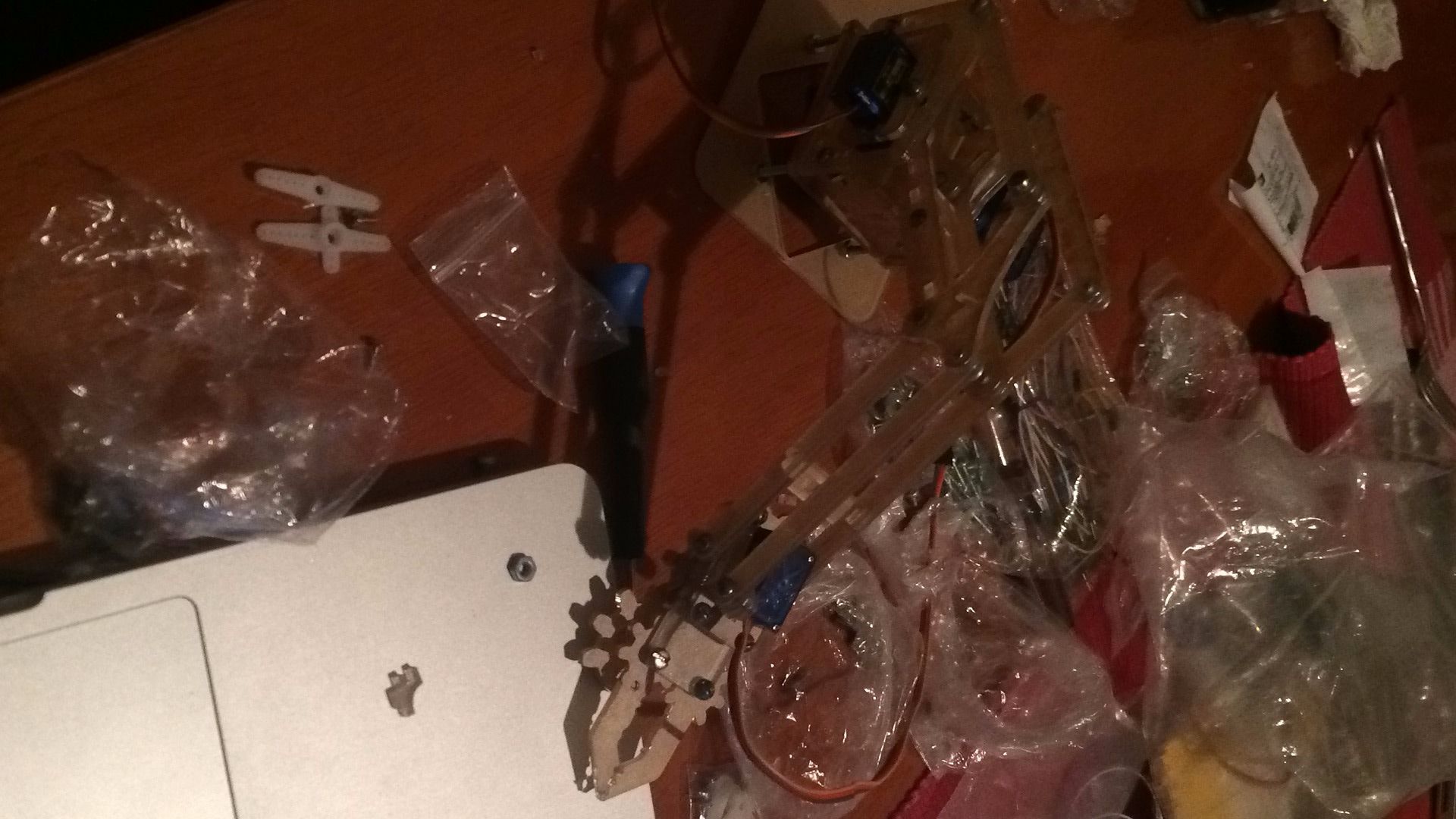

I made one out of 2.4mm hard board. It remains to be seen how well it holds up. Great project! I will be teaching a high school class next year involving engineering and electronics. May use this to let the students build their own. Great motivation to learn to program the Arduino.

phenoptix
phenoptix
Reply 7 years ago on Introduction
That looks amazing! I found with Ply that the screws pull through, but you can just use a longer screw with a nut on the end. Would be great to see a class building them! I'm headed to the Science Museum in London at the end of the month, hope to build around 100 of them over the 5 days with kids aged 10 and up.

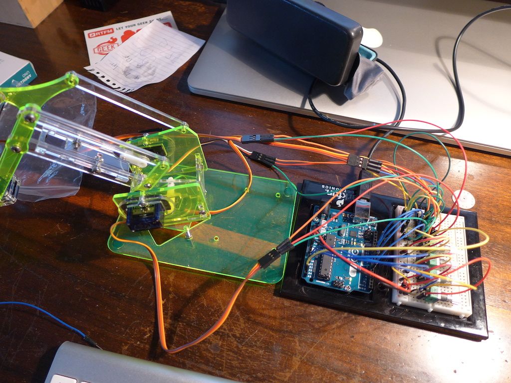

ok1cdj
ok1cdj

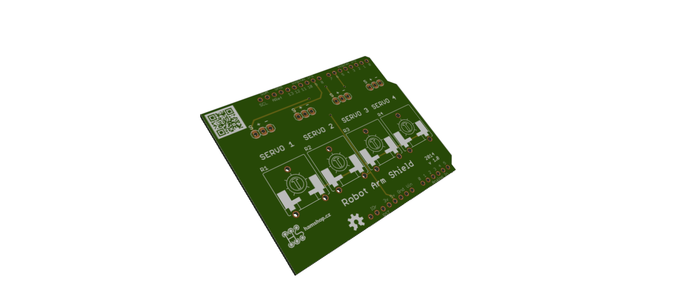

Hi, also building this nice project... I made Arduino shiled for easy connect of servos. I'm waiting for PCB from factory now...
