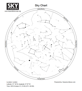

Go to https://skyandtelescope.org/interactive-sky-chart/. You can use a different sky chart website, but this is the one I like. Look up the coordinates of the location you want, choose “enter manually” and enter them. Enter your meaningful date. Click “submit”. Uncheck all the boxes and only check “constellation lines”. Print the star map out so that your lid fits neatly in it. It might require some experimentation to get the perfect size. Cut out the lid template shape from the star map positioning the cardinal directions in the corners.

Roll out another piece of dark blue clay to a thickness of around 2 mm. Put the template you made on the clay pencil down and cut out the shape. Place the star map on top. With a needle poke through the paper all the major stars and planets and score through the paper to mark the constellation lines. Remove the paper, use the needle to make the constellation lines clearer and use the dotting tool to enlarge the stars and planets. Bake according to package instructions.
