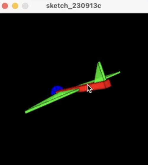

Learn how to visualize the MPU6050 angle data from the i2cdevlib in the Arduino Framework using Processing and Toxiclibs library. In the end, you will have an awesome animation that displays a plane on the screen orienting itself in three-dimensional space as you move around your MPU6050! The animation will appear as follows:
This animation will rotate depending on the orientation of your MPU6050, pretty cool. This is popularly known as the "teapot" example although the animation is no longer a teapot, as you can see it is a plane. This is a continuation of part 1 where we showed how to get angle values yaw, pitch, and roll, for the MPU6050.

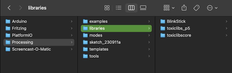

Step 1: Download Processing and Toxiclibs Library
Processing:https://processing.org/download
ToxicLibs:https://github.com/postspectacular/toxiclibs/releases/tag/0021 (download the complete zip file)
For the toxiclibs library, you only need two subfolders for the example code to run. Once you download the library extract the toxiclibs_p5 and toxiclibscore subdirectories into the Library folder under Processing. Screenshot shown here.
Step 2: Edit the MPU6050_DMP6 Example
In part 1 we worked with the MPU6050_DMP6 example to print angles on the screen in the serial monitor in PaltformIO. We need to make some modifications to modify the output so that the animation on the Processing side can interpret the angle data. To do so we only need to comment out the line,
#define OUTPUT_READABLE_YAWPITCHROLL,
and uncomment
#define OUTPUT_TEAPOT
Also, be sure the baud rate is 9600 and any delays are removed in the code so that the animation can be smooth. The code looks as follows (with my own offsets which should be different than yours).

We can then upload this to the ESP32 or whatever Arduino-supporting microcontroller you are using, the serial monitor will prompt you to enter a character (do not enter a character because the Processing code we will run will enter the char itself).
Step 3: Run Processing Code Example
The i2cdevlib also comes with the code we need to run in the Processing IDE. You can find this code in the i2cdevlib examples it is called MPU6050.pde
We can copy this code and paste it into a new sketch in Processing (you should have Processing downloaded at this point).
We only need to change the baud rate and the serial port in the code so that it can find the data being produced on the MPU6050 angle code in PaltformIO (or ArduinoIDE if you are using that). Here is the final code in my example.

I changed the baud rate to 9600 and also changed the serial port according to the ESP32 serial port on my Macbook. The format of serial ports is different for Windows or Linux so keep that in mind.
Once you have that setup you should be able to run the example you added into the Processing sketch, give it a moment and an animation will appear on the screen, let your MPU6050 settle for about 10 seconds, and begin to move it. Enjoy the magic!
