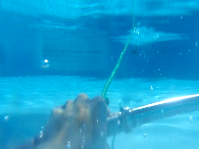

The Harder Way (still easy)
The pictures give you a sequence of events, but I'll detail it step by step here.
1. Obtain a large container with a semi-tight lid. Aim for something at least 5 Liters or 1.5 gallons; otherwise you may need to use multiple containers which adds complexity and error.
2. Fill the sink, tub, or submerge the whole thing all the way in a pool
3. Flip the container over so the opening is facing down under the water. If you can't get any last stubborn air bubbles out use the tube to suck them out.
4. Situate one end of the tube above the water to put your mouth on. Put the other end of the tube under the opening of the container.
5. Take several deep breaths and on the last one draw and hold as much air as you can. Exhale every last bit you physically can through the tube and into the container. Make sure the open end of the tube stays under/inside the container the whole time. A nose clip could help to ensure that you don't cheat and take any extra air in through your nose when your forcing out the last bit of air from your lungs.
6. You now have a bubble the size of your Vital Capacity (VC) trapped in the container.
7. With the open end of the container underwater, put the lid on your container.
8. Quickly flip the container over so that the water left from the opening of the container to the bottom of your VC bubble stays inside the container.

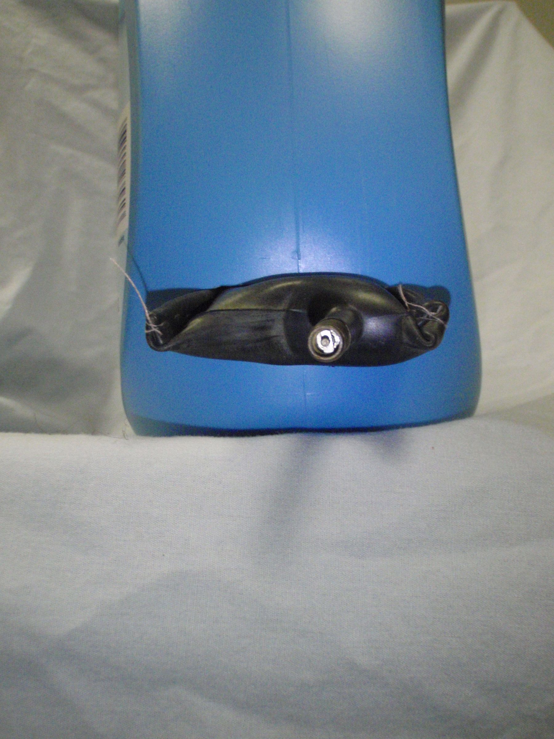

9. Fill a measuring cup with a known amount of water and fill the container to the brim with water. Keep track of how much water you add to the jar.
10. The volume of water that you added to the container to fill it to the brim is the Volume of your VC. Enter this value into the spreadsheet in either liters or US fluid ounces.
NOTE: I was surprised to find that my VC was surprisingly low; about 1.3 liters smaller than the average man. This resulted in a RC about 0.5 liters lower than the equation estimates. I may need to seek the advice of a doctor if some other people don't encounter a similar issue. In the end it only affects the calculation by about 3.6% which is within reason for this method.
