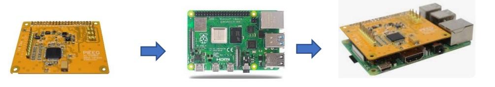

Connect PiEEG directly to RaspberryPi via GPIO40
Step 1: Install OS for Raspberry and Connect PiEEG to Rpi
For RaspberryPi4,5 (Pi4,5) install the Raspbian operating system

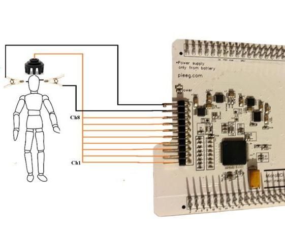

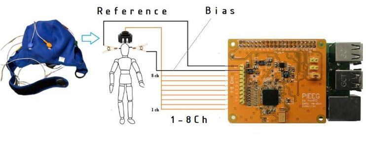

Step 3: Connect EEG Electrodes
Connect EEG dry Electrodes to PiEEG and two clip electrodes for ethe ar (reference and bias)

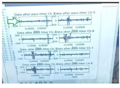

Launch the script
https://github.com/pieeg-club/PiEEG/blob/main/1.GUI/1.8_ch_Pi4.py
and
See the EEG data in real-time. You can operate via the open-source Python SDK to visualize EEG data and save Data
