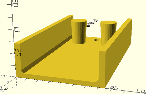

The solution was to make a little caddy for the scale. The caddy screws to the crank's pedal attachment hole, and the scale sits in the caddy and makes it easier to keep everything at right angles. I used a 3D printed thingy for this but you can also easily cobble together something out of scrap wood.
