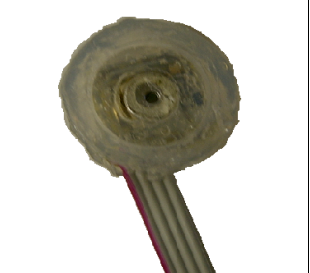

Step 11: You Are Done!
After curing, your sensor will be ready for testing. In order to do that, you can tap slowly on the membrane and check the microphone's output signal. You should be able to see the wave in a scope very clearly (for details on the electronic circuit check the first part of the instructable.). The membrane should quickly restore itself when deformed, otherwise, there may be an air leak. There is no reliable solution to air leaks... your best bet is to trash that sensor and start again.
By embedding in silicone, the sensor sensitivity has been passively increased. You have also enabled the microphone to measure really low frequency vibrations such as those produced by contracting muscles. Try placing the sensor in your chest and watch/listen your heart beats!
