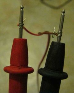

A good connection is necessary to keep the thermistor connected to the multimeter. To do so, solder two wires to the thermistor. The wire-ends should be wrapped around the multimeter leads to keep them in place. Any bare metal surfaces on the thermistor must be insulated because water is typically slightly conductive due to ions in the water. To insulate the thermistor, use blobs of hot-glue. Leave some part of the thermistor exposed.

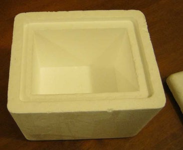

Step 2: Graduate Container

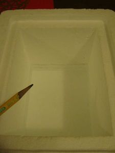

You'll need to pour in a cup of room-temperature (not critical) water into the container. Each time a cup is added, the top level should be marked with a pencil, pen, or marker. Doing this until the container is full results in a graduated container. You can then empty the container and pour in exactly four cups by looking at the graduations (think graduated cylinder).

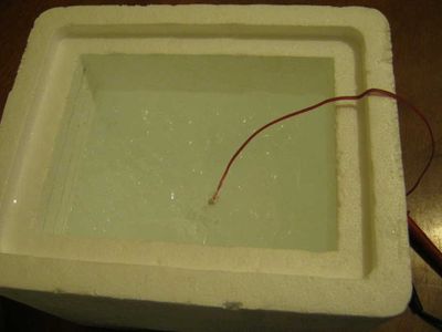

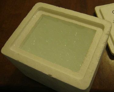

The Styrofoam cooler is used to keep heat transfer to and from the outside environment from having a significant impact on the water temperature inside the cooler. Do the following to collect the first measurement point at 0°C:
  1. Fill the container with solid ice.
  2. Add water to the container to cover the ice.
  3. Place the thermistor into the container.
  4. Cover the container with its lid.
  5. Wait 20-30 minutes for an equilibrium temperature to be reached between water, originally at room temperature, and ice.
  6. Take a measurement of the thermistor resistance at this point.

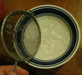

Once you're done, don't just dump the ice and water mixture out. Instead, use a strainer to remove the ice from the water. Because it's inside the cooler, it will still stay at 0°C for a long time while inside the cooler. This ice-cold water (but without ice) is needed to capture temperature points between 0°C and 100°C.

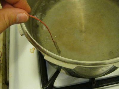

In order to model or calibrate an unknown thermistor, more points are needed. To do so, start by boiling a pot of water. Once there is a consistent rolling boil, the temperature is about 100°C. If you live at really high altitudes, adjust the boiling temperature to your specific elevation. Next do the following:
  1. Measure the resistance with the thermistor in water as it is boiling. This is the 100°C point.

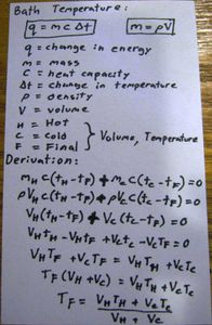

  4. Add 1 additional cup of the boiling water to the cooler.

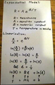

  • Exponetial Model: Typically, the marking on a thermistor is the nominal resistance at room temperature (25°C). If the manufacturer gives a B-value, this is the B-value used in the exponential equation. Given these facts, the A-value can be calculated, along with other values of resistance. This is the most popular model for thermistors because it is easy to use.

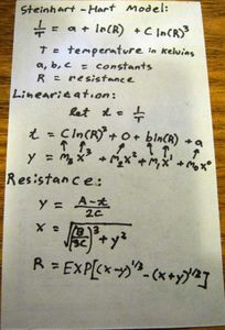

  • Steinhart-Hart Model: This is the most accurate model, but it is the most difficult to use mathematically.

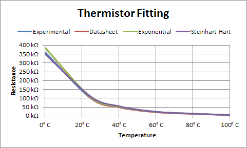

  • Graph: This shows the comparison of all the models. They're all pretty close to one another, except at cold temperatures.
  • Bath Temperature: This is the derivation of bath temperature given mixing of hot and cold water at specific volumes.
  • Exponential Model: This shows how linearization of the exponential model works.
  • Steinhart-Hart Model: This shows how linearization of the Steinhart-Hart model works. I didn't derive the conversion back to resistance, this was found using Wikipedia.
