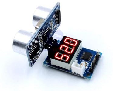

In this tutorial we are going to connect HC-SR04P module to Arduino using a serial connection & display the distance in Visuino Terminal window or in Visuino Instruments window.
Watch the Video!
Step 1: What You Will Need
  • HC-SR04P module with Ultrasonic Sensor HC-SR04

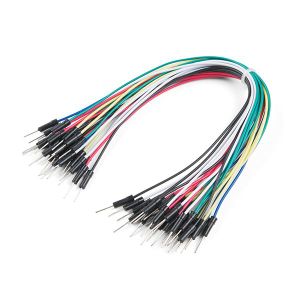

  • Jumper wires

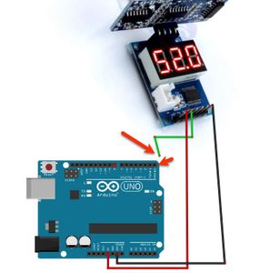

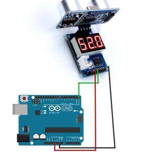

Step 2: The Circuit
  • Connect HC-SR04P module pin [VCC] to Arduino board pin [5V]
  • Connect HC-SR04P module pin [GND] to Arduino board pin [GND]
  • Connect HC-SR04P module pin [TX] to Arduino board pin [RX]

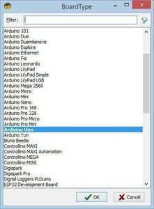

Step 3: Start Visuino, and Select the Arduino UNO Board Type
Start Visuino as shown in the first picture Click on the "Tools" button on the Arduino component (Picture 1) in Visuino When the dialog appears, select "Arduino UNO" as shown on Picture 2

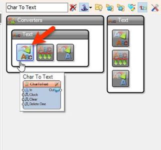

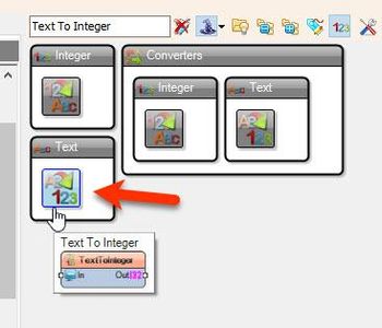

  • Add "Char To Text" component

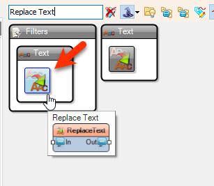

  • Add "Replace Text" component and in the properties window set "From Value" to D:
  • Add another "Replace Text" component and in the properties window set "From Value" to  cm
Note that there is a space in front of cm
  • Add "Text To Integer" component

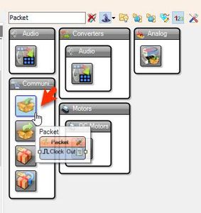

  • Add "Packet" component

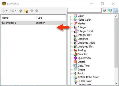

  • Double click on the "Packet1" component and in the "Elements" window drag "Integer" to the left side

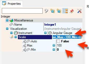

  • Optional: you can select a different Instrument in the properties window or set the MAX or MIN scale

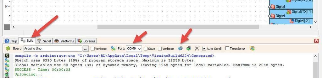

Step 7: Generate, Compile, and Upload the Arduino Code
Note: Before uploading the project disconnect pin [RX] on the Arduino board and after the upload connect it back
In Visuino, at the bottom click on the "Build" Tab, make sure the correct port is selected, then click on the "Compile/Build and Upload" button.
