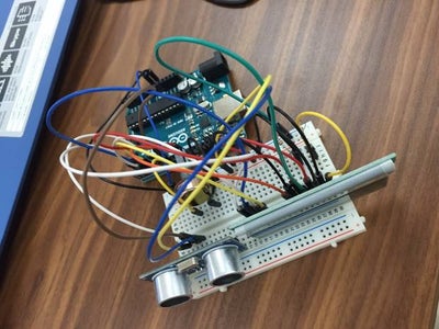

Introduction: Measuring Distance and Showing It on LCD Screen Using Arduino
In this project we will connect the LCD and the ultrasonic sensor with the Arduino in order to measure the distance and display it on the LCD Screen

Step 3: Connection
1-Ultrasonic
  • Vcc to 5V in the arduino
  • trig to port 2 in the arduino
  • echo to port 4 in the arduino
  • Gnd to Gnd in the arduino
2- LCD
  • LCD RS pin to digital pin 12
  • LCD Enable pin to digital pin 11
  • LCD D4 pin to digital pin 5
  • LCD D5 pin to digital pin 4
  • LCD D6 pin to digital pin 3
  • LCD D7 pin to digital pin 2

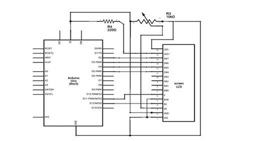

Additionally, wire a 10k pot to +5V and GND, with it's wiper (output) to LCD screens VO pin (pin3). A 220 ohm resistor is used to power the backlight of the display, usually on pin 15 and 16 of the LCD connector
you can follow the diagrams for both connection , LCD is a bit tricky since it have lots of wires
Step 4: Schematic
