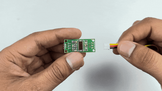

Step 1: Connecting Electrode Cable
Connect the BioAmp Cable to Muscle BioAmp Candy as shown in the connection diagram. We have different variants of the BioAmp Cable so don't go with the color coding and focus on the REF, IN+ and IN- written on the Muscle BioAmp BisCute.
