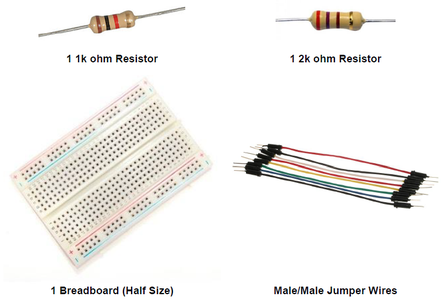

  • 1 Breadbord.

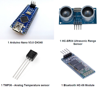

  • 1 Arduino Nano V3.0 CH340 with mini usb cable.
  • 1 HC-SR04 ultrasonic sensor.
  • 1 TMP36 digital temperature sensor.
  • 1 Bluetooth HC-06.
  • 1 1k ohm resistance.
  • 1 2k ohm resistance,
  • Male/male jumpers cable.
  • Male/Female jumpers cable.

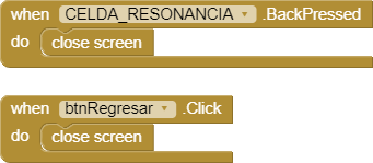

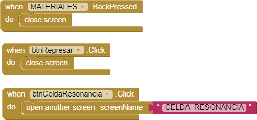

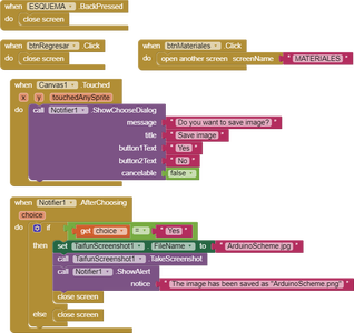

Step 3: App Inventor 2 Blocks
The data processed by the Arduino microprocessor is transmitted via bluetooth to a mobile phone app (Android 10) designed using a visual programming environment called MIT App Inventor The programming blocks and the app (SoundSpeed_2021.apk) are attached in this section.
The application consists of an initial screen where, once connected via bluetooth to the measuring probe (button with Bluetooth Icon), the value of the measurement of the sound speed (m/s) of the gas contained in the probe is reported. The reported value is the average of 7 measurements, and the measurement temperature (°C) as well as the standard deviation of these two data are also reported. This data can be saved on mobile after a file name (SAVE button) is assigned.
This initial screen also displays five buttons that allow you to:
  • Know the circuit and basic components that make up the measuring equipment (CIRCUIT button).
  • Measure the length of the measuring probe (m) using a reference gas (CALIBRATE button)
  • Once calibrated the equipment make an approximate identification of the identity of the gaseous substance in measurement (IDENTIFY button)
  • Disconnect the bluetooth sensor (DISCONECT button)
  • Exit the application (EXIT button).
The screen that is displayed when you press the CALIBRATE button displays four buttons that allow you to:
  • Select a reference gas (REFERENCE GAS button) that will allow you to calibrate the length of the measuring probe.
  • Save the measured measuring probe length value for use in measurements made in unknown gas samples (SAVE button).
  • Clear the saved measurement probe length value (DELETE button).
  • Make measurements to the sample of unknown gas (MEASURE button) that will return us to the initial screen.
Once the measuring probe has been calibrated and the measurements have been made to the unknown gas, the identification of the same is carried out by pressing the IDENTIFY button that takes us to a third screen showing the sound speed value measured as well as its coefficient of variation in addition to a list of possible identifications of the gaseous substance under study.
In this list, the candidate with a lower error % value will be the one to be taken as the most likely identification candidate.
On this screen there is a button that allows you to copy the results to the mobile in image format (SCREENSHOT button) and another that will return us to the initial screen (RETURN button).
