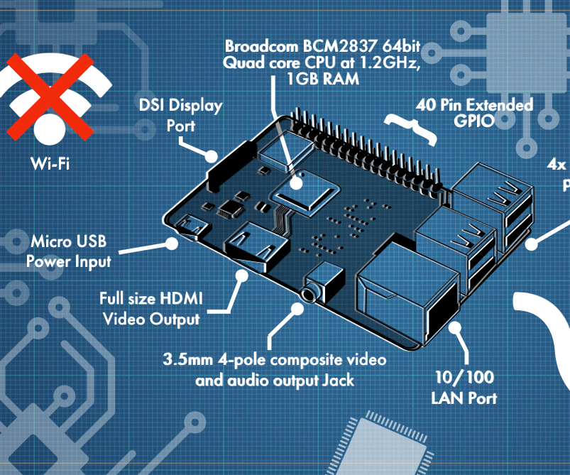

Introduction: Measuring Soil Moisture With Raspberry Pi 4
Do you know how often to water plants? Or outpoured plants and lost them. To solve this I thought it would be more circumstantial if we can get the value of water content inside the soil in order to make a decision for watering the plants appropriately.
In this project lets try to build a circuit which can measure the water content value of the soil eventually control the flow using Raspberry Pi.
Hardware:
  1. Raspberry Pi 2/3/4
  2. Soil moisture sensor
  3. MCP3008 IC
  4. Jumpers
