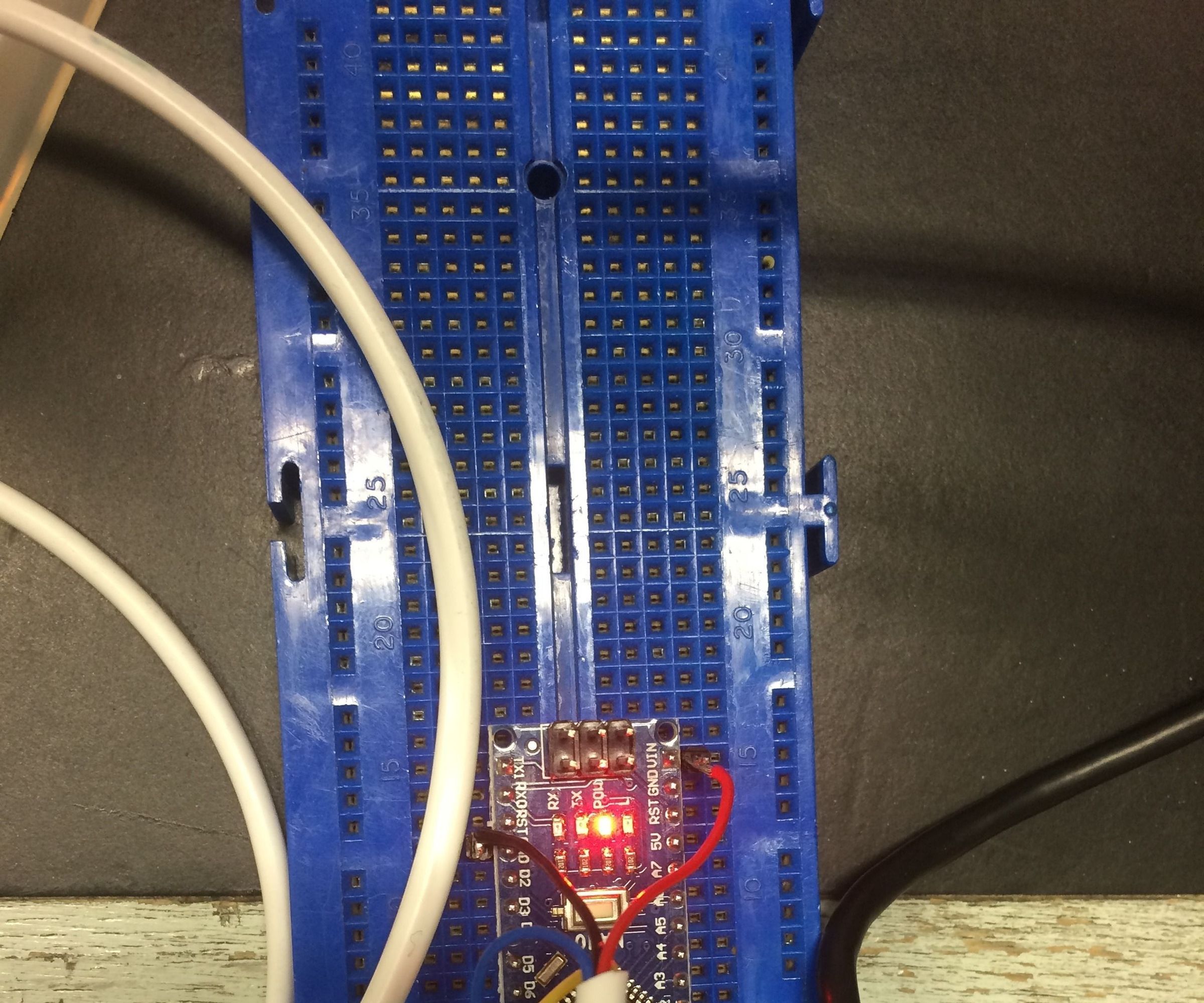

Step 13: ARDUINO MICROCONTROLLER
The Arduino is a programmable microcontroller featuring digital and analog I/O ports. The microcontroller was programmed to read the voltage from the amplifier via an analog input pin. First, the Arduino will read the voltage from the circuit output range 0-5 V and convert it to 0-1023 DU and it will print the value. Next, the analog value will be multiplied by 5 and divided by 1023 to get the voltage value. This value will be multiplied by 20 to give the exact scale for the temperature range from 0-100 C.
To get the offset and sensitivity values, the readings from the input pin on A0 were taken with different values for the PT100 and the graph was plotted to get the linear equation.

Step 16: Setting Up the Arduino
connect the output of the circuit amp to the A0 input pin of the Arduino
Connect the Arduino Nano via the USB port on a PC.
paste the code to the Arduino sketch workspace.
Compile the code.
Select Tools > Board > Select Arduino Nano.
Select Tools > Port > Select COM port.
Upload the code to the Arduino.
The digital value outputted is the voltage output of the op-amp (should be 0-5V)
The temperature value is the systems read temperature in Celsius.
