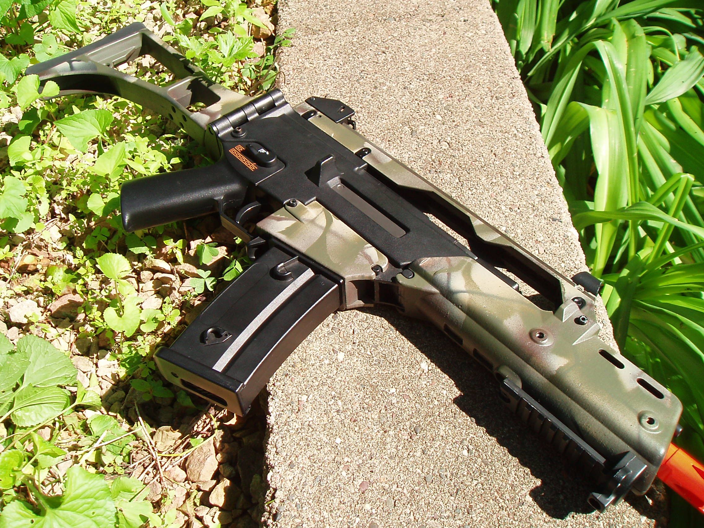

Gun

Step 1: Record the Gun
Put the mic somewhere near the barrel record at least one second of continuous fire.
