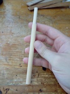

1x round wooden pole, about 15 cm in length

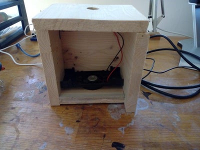

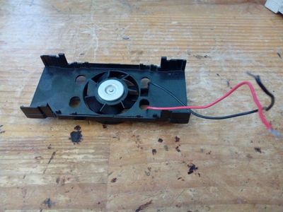

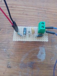

I picked a similar kind of PC fan that I got from a junkyard computer and followed the steps from the video. The fan is rated for 5 V. Note that removing the circuit is absolutely necessary. The various components won’t allow current to flow out of the winding. Speaking of the circuit, I highly recommend you try figuring out the way it works (or, you could just watch this video of a great explanation instead)! After removing the circuit and reassembling the fan I could blow very hard at the fan and measure a couple of volts of AC current with a voltmeter. This seemed very promising, so I continued. I built a very simple rectifier circuit to change the induced AC voltage into DC. The circuit I went for is shown in figure 1.
As you can see, it’s a very basic half-wave rectifier. R1 is the resistor over which the voltage is measured. Since I hadn’t done any measurements yet I decided to go for a current limiting resistor (R2) and an over-voltage protection with a Zener diode (ZD1) with the Zener voltage equal to 5.1 V. The capacitor C1 smooths out the rectified voltage. The circuit would work fine without a capacitor, however I believe it’s good practice to use it. It’s also a good learning experience trying out different values of the capacitor. I ultimately ended up with a ceramic capacitor with a value of 0.1 nF.
I prefer this setup as opposed to a full-wave rectifier because it’s very simple both to understand and to build. Since I’m not after the generated power but rather the amplitude of the signal, a half-wave rectifier is just as useful as a full-wave rectifier would have been with less parts and potential problems.

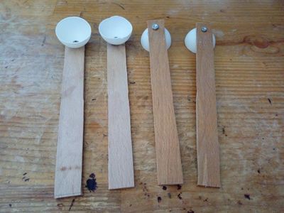

Step 4: Building the Propeller and Enclosure

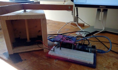

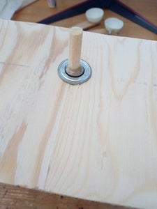

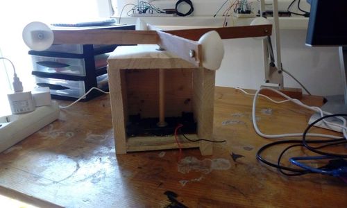

I took a page out of the Explaining Computers’ design I linked to earlier in this article. I decided to make it out of some scrap wood, ping pong balls and hardware I had lying around the workshop. I decided to plug the shaft through a ball bearing in the roof of the enclosure. For the testing phase I left one side open. All the described parts are visible in the pictures above.

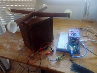

After the woodworking was over I hooked the wires up to my circuitry and spun the propeller by hand. I wrote a function that finds the peak value read by an analog pin in a given time period (the same function is in the final program, it’s called wind_speed). The readings were quite lacklustre. As opposed to the previous reading of several hundred I had a hard time going over 40. After trying out different diodes I could bump the maximum measurement achievable by hand to around 100. This left a bitter taste so I did some research and found this interesting article. It appears that a person doing their best to blow air out of their mouth will produce “wind” with speed of up to 200 km/h. This means that my blowing into the fan was way more effective than spinning the awkward propeller by hand. This means that a stronger wind would produce even higher measurements which gave me a good feeling about the signal amplitude so I decided not to use any signal amplification.

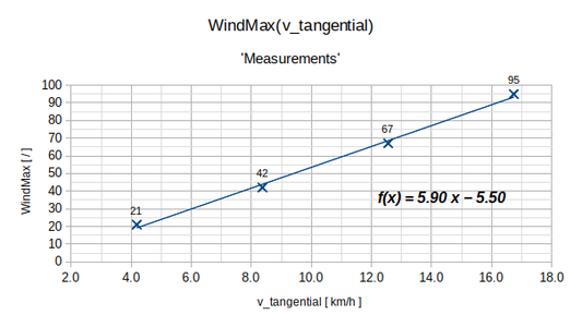

Equation 2 represents how the tangential speed (which, I presume, roughly equals the speed of the wind) depends upon the frequency. We can now spin the propeller by hand with different frequencies and measure the induced voltage. By applying equation 2 we then have a direct correlation between the speed of wind and the measured voltage. I spun the propeller with frequencies of 1 Hz, 2 Hz, 3 Hz and 4 Hz taking advantage of a metronome to keep my rhythm on point. I found that higher frequencies were too difficult to accurately produce by hand so I stopped here. I did 5 measurements for each frequency and chose the mode value from among the five. The measurements and calculations including the frequencies, speeds of air, analog readings and corresponding voltages are collected in table 1. The speed of wind is calculated in meters per second from equation 2. Afterwards, I changed those values to kilometers per hour since that's the unit of wind speed that we're used to.

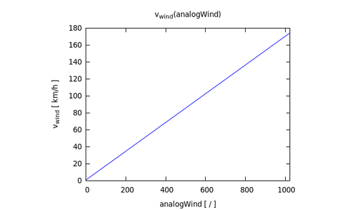

Furthermore, I drew the graph pictured on figure 2 to better visualise the correlation between the speed of the wind and the analog readings of the Arduino. It appears to be remarkably linear so I fitted a linear curve on the obtained data and printed out the lines’ equation.
Finally it’s time to write a program that reads the analog value and spits out the speed of the wind in km/h. For this we will need the inverse function of the function equation 2:
g(x) = f⁻¹(x) = (10x+55) / 59 (3)
The final program, available on my github and in the download section of this article takes advantage of function (3) to calculate the speed of the wind and write it out every few seconds.
I also went ahead and plotted the function from equation 3 (figure 3).I plotted the function in the range from 0 to 1023, which is the range in which the 10-bit DAC of the Arduino boards operates. It seems that the maximum wind speed that can be measured is around 170 km/h. The maximum wind speed in my parts is around 120 km/h which only occurs once or twice per year. This means that I should be able to measure the wind speed under any conditions successfully. It also means that the Zener diode over-voltage protection is likely unnecessary but I’ll leave it just in case something unexpected happens.

Finally, I created the circuit on a piece of perfboard, drilled a hole in the bottom of the enclosure to drive out the cables, closed up the wooden enclosure and painted it with an outdoor wooden paint to make it last long under changing weather conditions. I also lightly greased the ball bearing to help it spin more smoothly and give it some protection against corrosion.
I’ve yet to test this setup under stronger wind. I do believe the electronics are capable of reading it, however, I’m hoping the construction is sturdy enough to withstand strong wind.
If I ever redo this project I’ll look into a better propeller, this one seems a bit too improvised for my taste. The same goes for the enclosure which does look a bit too dull. I would also like to test out different kinds of generators. I do however enjoy the fact that almost everything was made from scrap electronics, wood and hardware parts.
