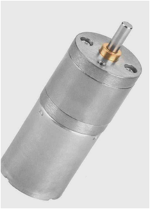

  1. 25mm Geared Motor High Torque (you will need to get a 25mm diameter and 4mm shaft diameter high torque motor with a rpm of 500rmp to 1200rpm).

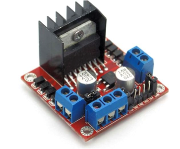

  2. L298n motor driver

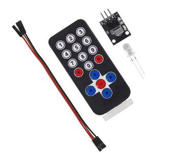

  4. Infrared (IR) Wireless Remote-Control Module

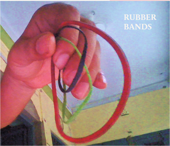

  7. 3 x rubber band (It is important as it helps the yarn stick to the wheel.)

Before running the code, make sure to install the “IRremote” library using the Arduino IDE’s Library Manager. Once installed, upload the code to your board.
If your remote matches mine, the controls are mapped as follows:
  1. Button 1 → Start the motor
  2. Button 2 → Stop the motor
  3. Button 3 → Toggle direction
  4. Up Button → Increase speed
  5. Down Button → Decrease speed
Step 3: Customize Arduino Code As You Like
I you're using a different remote then just open the Serial Monitor and press each button to observe its unique signal code.
Replace the existing values in the code with yours accordingly.

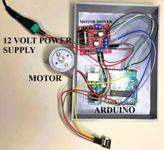

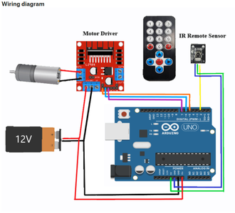

Step 4: Hands-On: Bridging the Circuitry
Connect the Arduino and other components as shown in the wiring diagram.
  1. Power Source Setup: Connect the positive terminal of a 12V battery (or a compatible 12V power supply) to the 12V input on the motor driver. Attach the battery’s negative terminal to the GND pin on the motor driver.
  2. Powering the Arduino: Link the Arduino’s Vin pin to the battery’s positive terminal. Connect the GND pin on the Arduino to the battery’s negative terminal.
  3. Motor Connection: Attach your motor wires to the OUT1 and OUT2 terminals on the motor driver module.
  4. IR Sensor Wiring
  5. Connect the sensor’s GND to the Arduino’s GND.
  6. Connect the sensor’s VCC (positive) to the Arduino’s 5V pin.
  7. Connect the sensor’s signal (S) pin to digital pin 2 on the Arduino.
  8. Arduino to Motor Driver Control: Connect the motor drivers:
  9. First control pin to Arduino pin 5
  10. Second control pin to Arduino pin 6
  11. Third control pin to Arduino pin 7

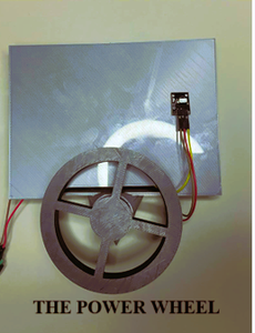

Step 5: The Assembly Blueprint
Follow the procedure: -

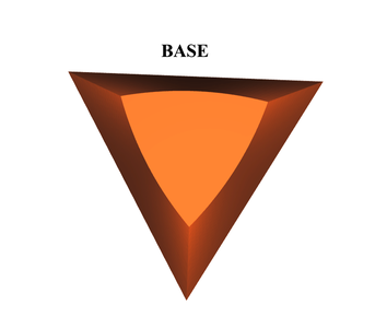

  1. Print all parts once, except for the “base,” “base cover,” “protective cover,” and “pulley” Print these twice.

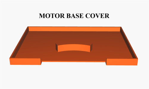

  2. Install all electronic components inside the “motor base” and seal it with the “motor base cover.”
  3. Ensure the IR sensor is positioned on top so it can receive signals from the remote.

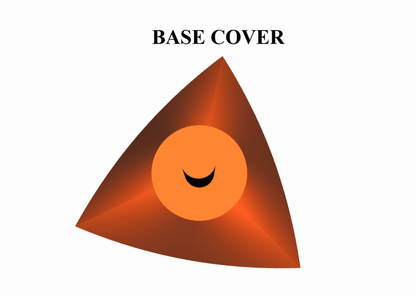

  4. The “base” is intentionally hollow. You may even fill it with any heavy materials you have on hand, like bolts, screws, or Gibson filled with water, to provide stability when the cat interacts with the device.
  5. Once the base is filled, secure the “base cover” using super glue, then place a bearing on top, followed by the “pulley” part. You may apply glue here as well for additional stability.

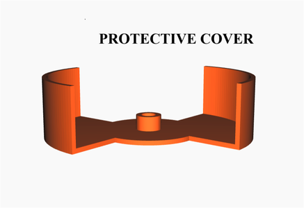

  6. Install the “protective cover” over the pulley, ensuring it doesn’t interfere with the yarn’s movement. Fix it in place with super glue. Note: This part may not appear in images as it was a recent addition.

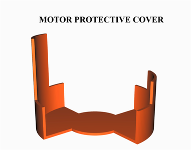

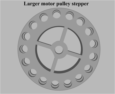

  7. Mount the motor on the motor base, route the wires through the provided gap, and attach the “motor pulley” on top. A separate “motor protective cover” fits over the “motor base cover” to hold everything in place. Again, use glue to keep it secure.

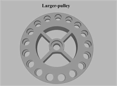

  8. Finally, wrap rubber bands around all three wheels to improve grip with the yarn. Wind the yarn through the pulleys and attach a toy or ribbon at the end for playful interaction.

One practical and impactful modification for improving pulley-based mechanisms is deepening the grooves on the wheel rims for: -
  1. Improved String Retention: Deeper grooves significantly reduce the chances of the string slipping or derailing during setup or high-speed operation.
  2. Greater Compatibility: With deeper channels, you can also use slightly thicker strings or ropes without compromising performance offering more flexibility in material choice.
  3. Enhanced Safety: A more securely seated string means there's less risk of sudden disengagement, which could otherwise cause tangling, jerks, or even minor injuries in fast-moving setups.
  4. Durability Boost: Because the string experiences less lateral movement, there's reduced friction against the pulley rim edges. Over time, this helps prolong both the string’s lifespan and the pulley’s surface integrity.
  5. Custom Groove Profiles: In the future, 3D printing or CNC machining could allow tailoring groove profiles not just in depth but also curvature for specific use cases like multi-string arrangements or bidirectional tension systems.
