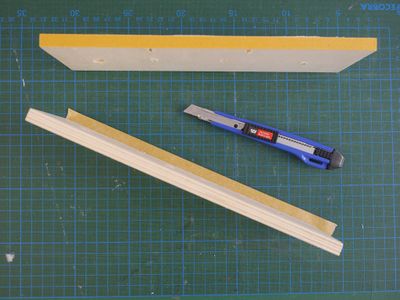

Step 5: Attach Parts #2 and #3 With Tape
Remove the drilling template from parts #2 and #3 and attach them to the back plate with double-sided tape so that no extra tape is visible, as the pieces will be drilled at a later step. Be careful to tape the pieces the correct way around and part #2 on top.

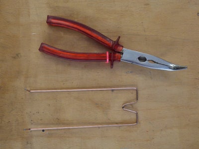

Bend with strong pliers the large rubber band holder on top of the seismograph from 2 mm welding rod (#15). Please see the photo for the shape.
Attach the top rubber band holder to the 5 mm steel rods that carry the pen holder using tape and ca. 3.6 x 140 mm tie-wraps. Attach also a rubber band (#22, ca. 1.5 mm in diameter) to the dent on the top of the rubber band holder with the other end attached around the pipe in the pen holder. When attaching the rubber band, hold the seismograph upright, as it would be on a bicycle, so you can see how low the pen holder hangs. The tension of the rubber band should be such that the pen holder is near the middle (not too low or high, as the pen will move up and down when bicycling). It is good not to make too many knots at this point and to leave a bit extra in the rubber band, as it can be that the rubber band needs to still be adjusted depending on how well the pen holder moves.
