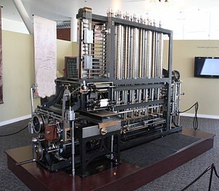

I have long been fascinated by the work of Charles Babbage. He designed the first programmable mechanical computers back in the 1830s. First the Difference Engine to calculate tables of numbers, and then a general purpose computer, the Analytical Engine. In his lifetime, they were never completed due to funding problems, disagreements with his machinist and a failure to stick with a design. If they had been finished, we might have had mechanical computers a full century before the electronic models of the mid-1900s.

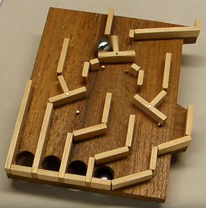

I have also been captivated by rolling ball sculptures and marble runs. The motion of the balls through the different track elements is mesmerizing. A flip-flop can be used to send balls alternately onto two different tracks. Essentially, it is a switch that changes state every time it is “read” by the next ball.
The use of a marble or metal ball with flip-flop gates as a form of mechanical logic occurred to me almost immediately, and apparently to others as well. I found the work of Matthias Wandel, Evil Mad Scientist and Eric Uhrhane, and I marveled at the work they had done. It is time to build on the ideas of others and do some science.

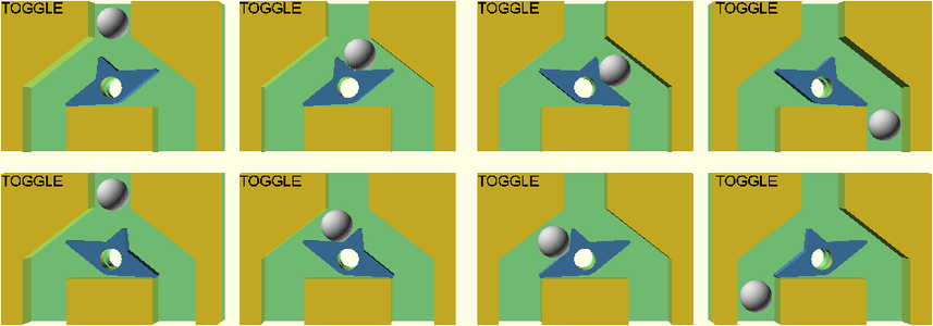

The first image shows the behavior of a TOGGLE gate when a ball is input. The initial state is FALSE. When a ball (TRUE) is input at the top of the gate, the ball flips the Toggle to TRUE and exits to the lower right. When another ball is input, the Toggle flops to FALSE and the ball exits to the lower left.

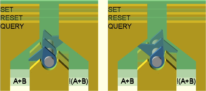

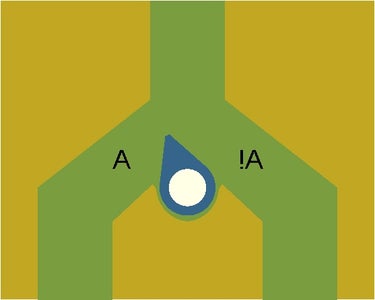

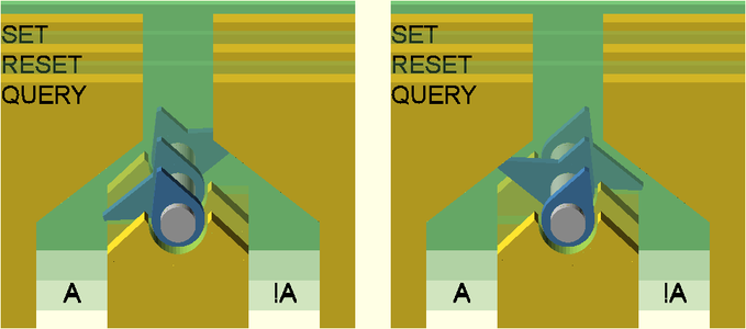

The simplest Boolean operation is NOT. If an input value is TRUE, the output is changed to FALSE. If it is FALSE, it becomes TRUE. To model this in ball logic, a Set gate is stacked with a Query gate and a Reset gate on a single shaft. Initially, the gate is set to FALSE, with all of the gates tipped to the right. In the model, the “A” and “!A” labels indicate the value of the ball as it passes through the Query gate. If a ball (representing TRUE or 1) is inserted at the top of the Set, it tips the Query gate so that the query ball runs through the !A path. To reset the gate, a ball is dropped through the top of the Reset gate to tip everything back to FALSE.
In addition to the Boolean NOT, this gate also acts as a buffer, allowing us to query the value later in a calculation. This is a distinct strength of these ball logic gates: you get both the Boolean operation and its compliment at the same time. You simply decide which path to read.

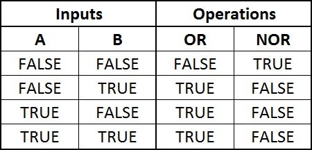

The Boolean OR evaluates 2 or more inputs and returns TRUE if at least one of them is TRUE. The implementation of OR in ball logic is identical to the NOT/BUFFER gate shown in the previous step. The inputs A and B are both fed into the SET layer of the gate. If one or both of them are TRUE (or 1), the gate returns TRUE when queried.

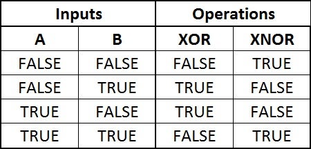

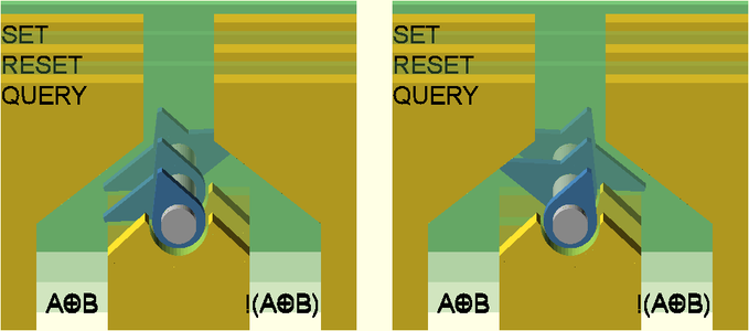

The XOR (Exclusive OR) is very similar to the OR, but substitutes a TOGGLE for the SET gate. Just like the OR, inputs A and B are fed into the toggle. When one-and-only-one of the input signals are TRUE, the output of the QUERY is TRUE. If neither or both of the inputs are TRUE, the QUERY returns FALSE as shown in the truth table shown above.

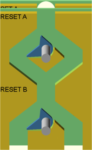

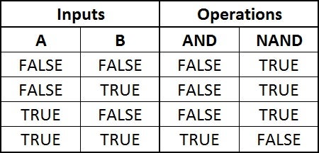

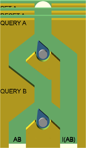

The Boolean AND operation returns TRUE only if all of the inputs are TRUE. The implementation in ball logic is 2 connected NOT/BUFFER gates. The when a ball is dropped into the QUERY path, the state of input A is evaluated first. If A is FALSE, the ball falls through to the output as FALSE and the state of B is not evaluated. If A is TRUE, the ball is directed to query B. If B is FALSE, the output is FALSE. Only if A and B are both TRUE will the output be TRUE.
The signals for A and B are input from the side of the gate rather that the top because of the vertical alignment of the SET layer. The RESET layer has additional ball paths so that both A and B can be reset with a single ball.
