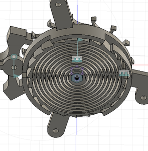

Using 3d printed parts from supplies, first assemble the torsion spring holder on top of the torsion spring, and assembling the mainframe, with the anchor and wheel in their respective places.
All moving parts can be fixed with the general 4.9mm or 4.8mm shaft. Preferabbly get a shaft that has a slightly resistive fit, then use sandpaper till it could rotate freely with minimal translational movement.

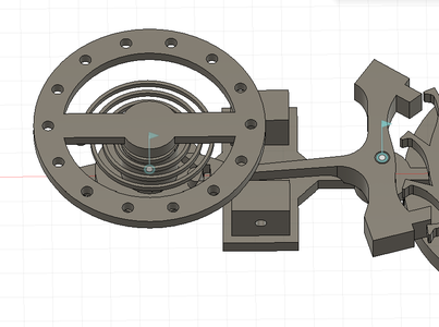

Step 2: Assembling the Escapement

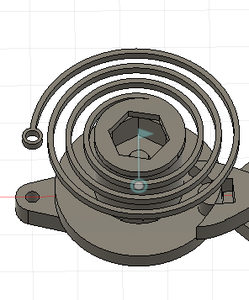

In this step, you first put the jewel onto one of the 4.9 or 4.8mm shafts, fix a 2.9 mm shaft on the outermost hole, then attach the hairspring(the smallest spring) as shown in the picture.
After this is done you can put the module called 'weight' on top. Notice the numerous holes on the weight module. This can be used to put screws that can fit into a 4mm hole in place, and a nut at the end for extra weight.
Then, assemble the top half of the mainframe, using 4.9 or 4.8mm shafts to fix it in place as neccessary, and use 5mm spacers to raise the secondary platform above the first mainframe.

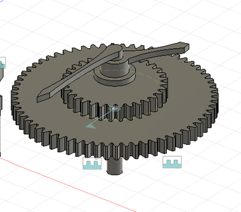

Step 3: Assembling the Gears + Second and Minute Hand
All gears can use the general 4.9mm shaft. Use spacers when neccesssary.
Start by assembling the 32 tooth on top of the central wheel, then attach as follows:
  1. 32 to 60-> 32 to 60-> 40(on the same shaft)-> 8 -> 48 to 8(48 is facing up, 8 is facing down) -> 80
  2. The numbers represent the amount of teeth each gear has
  3. The minute and second hand fit together, and is to be placed through the second 32 to 60 tooth gear
