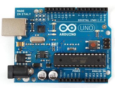

Step 3: Write Code + Test Out With Arduino to See If It Works
Write the code and plug everything into the Arduino.

Step 4: Schematics of the Electronica
Here is the schematics of the electronica

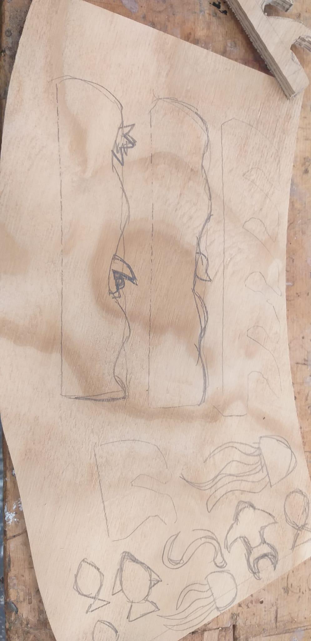

Step 10: Wood Cutting
The project needs to look presentable, and a couple of boxes aren't going to cut it so it's time to go to the woodwork area and cut and sand all the tiny items. I could've done it with the laser cutter as well but I know how that works. Also it looks bland and boring. I wanted to learn more about how to work by hand with wood.
I started off with sketches on some leftover wood, there is a load of it, and mostly no need to buy new wood unless you want to make furniture. We have a sea dragon, a leviathan so it's fitting that the setting would be underwater/sea. I Cut out sea creatures such as fish, octopi, starfish, sea snakes, sea snails, a clam, and some coral. Working with such small, precise, and delicate wood pieces is dangerous with the big machines, thank goodness I have longer nails than my finger because if I cut into my finger I can feel some vibrations of the nail and I can react before it actually cuts me. Basically don't work with small things again, use the laser cutter. But I have already started so I must continue.
I made waves for the top and sand for the bottom of the automata. I made a box to hide the soldering and Arduino. I thought of stacking the box and the sea dragon but then the dragon could not swim towards the gold coin. Because that's what he's after and triggers the whole mechanism so it's in front of it.
