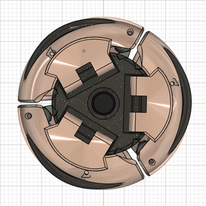

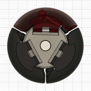

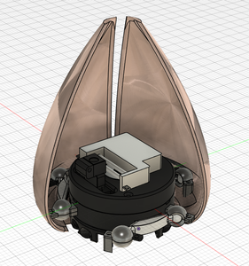

I started by loading up my CAD software of choice (Fusion360), these are screenshots of the first attempt at the CAD for this model which quickly developed into the next few screenshots which is featuring the most current design. For the first few weeks of designing this model, I was just working off my drawings and as the CAD progressed, I stopped looking at them and started using the CAD as my drawing. This proved to me that I am finally starting to understand Fusion360, a large achievement for me.

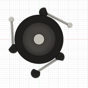

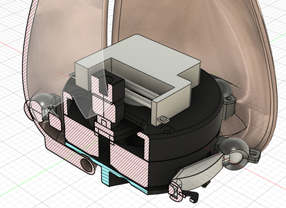

The main challenges with this design were with the nature of its small size. I had to print all parts at a 0.05mm layer height with a 0.2mm nozzle. Another challenge was with the fact that due to size constraints, I had to use a linear motor for a rotary movement resulting in a more complex mechanism. (second photo). keep in mind that this entire project fits in the palm of my hand measuring at in at only 50mm tall (complexity is not wanted). In the future I will change this to a geared track with a rotary motor.

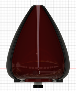

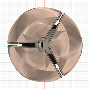

After many iterations, these are the final screenshots of the main orthographic views of my model. While many things did change, the main structure stayed the same including the incredibly small size that made this thing nearly impossible to 3d print via a traditional 0.4mm nozzle. Many parts had to be optimized with "thick" walls in order to be printable at all.
