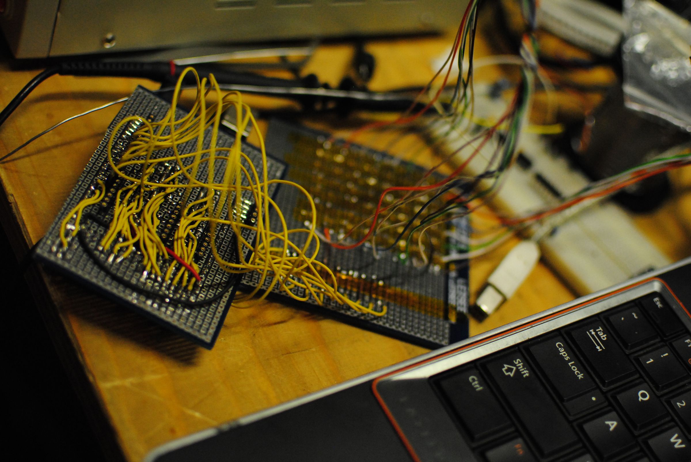

Step 2: Drive the LED Matrix Displays
In order to get the LED matrix displays working, we needed to do a mapping between the characters we wanted to show and a sequence of LEDs that should be enabled on the display. Every LED is driven by a single line by the MAX72XX chip.
The issue of having to use a wire per LED is solved by using a shift register. In this case it was already present on the LED matrix itself. The interfacing with the Arduino itself is done using SPI, which enables you to drive 64 LEDs with just 3 wires (10, 11 and 12 on the UNO).
After hooking up the display, we ran an example program and saw the LEDs light up nicely. However, there was a small bug in the setup, as for some reason the last line was shifted to the top of the matrix, This caused certain letters to be truncated. We solved this by bitshifting the pattern for each character to the right just once.
After some searching we found a complete character to bit pattern mapping for those LED matrices on the AVR freaks forum.
Now it was just a matter of making some code that was able to map a single character to its corresponding bit pattern. We did this by using a 2D array and casting a given character to it's corresponding int value (1 - 128) and use this as a first index for the 2D array.
When we had the first display working, we decided to add a second one. The wiring is quite easy here, you can just daisy chain the second starting from the first one. The library that comes with the display is also well written and the code was easily adapted (just duplicate a couple of lines)
