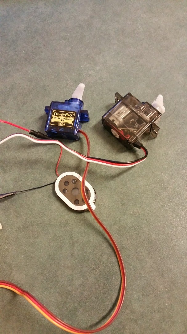

  • Two Servo Motors
    • The motors I used included a SG90 9G servo for the tail and an aftermarket servo used in RC planes for the mouth

  • 8 ohm 1W Speaker

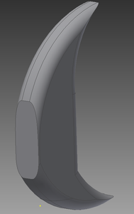

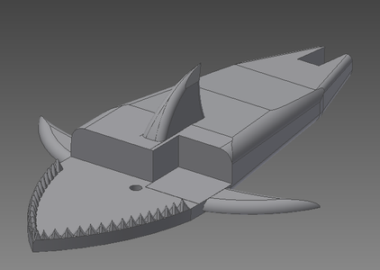

Step 2: 3D Printed Parts
Above are the 3D printed parts I used for this project. Attached are the files for the solid models.

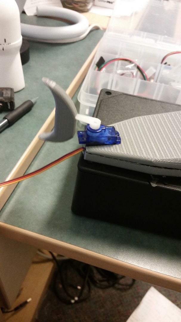

  2. For the tail servo, I designed the back of the bottom jaw model so that the servo would simply slide right into place. Superglue is optional, but isn't completely necessary. I did not include any tolerance for the gap, so it's a very snug fit.

  8. Very carefully glue the small arm of the top jaw to the mouth servo motor. You may need to tape it to hold it into place to ensure a strong bond, or consider using epoxy or printing a piece to fit the servo motor. This was one of the weaker points of my project, as it was very fragile around that point. Paint over the glue to cover it up.
