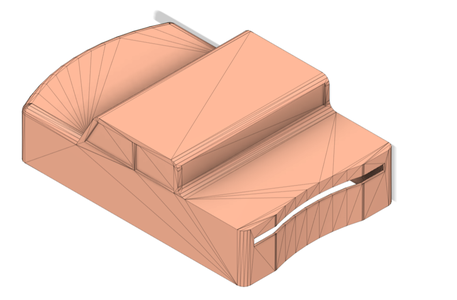

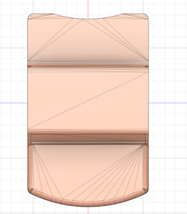

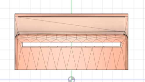

Step 1: Design of the Chasis and Exterior Frame
We used the Autodesk Inventor program to design the robot's outer case. We adjusted the design so that it would fit perfectly on the plastic design on the base where the Arduino was placed. First, we extruded the correct model on the appropriate sketch on the base. Then, we cut some sections from the side to adjust the front and back. Thus, the front and back bumpers emerged. We also cut the model towards the inside using the offset command for the glass areas. In the next stage, we opened a flat strip-shaped headlight area to be able to put LEDs on the front and back of the robot. Finally, we added sections to the bottom of the model so that it can be easily mounted. Thus, the outer design of the robot was completed.
  1. Exterior_Frame.stl: 3D model for 3D printing.
  2. Mecanum_Chasis.dxf: 2D layout for laser cutting.
