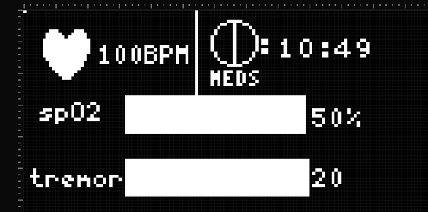

  6. Small OLED display

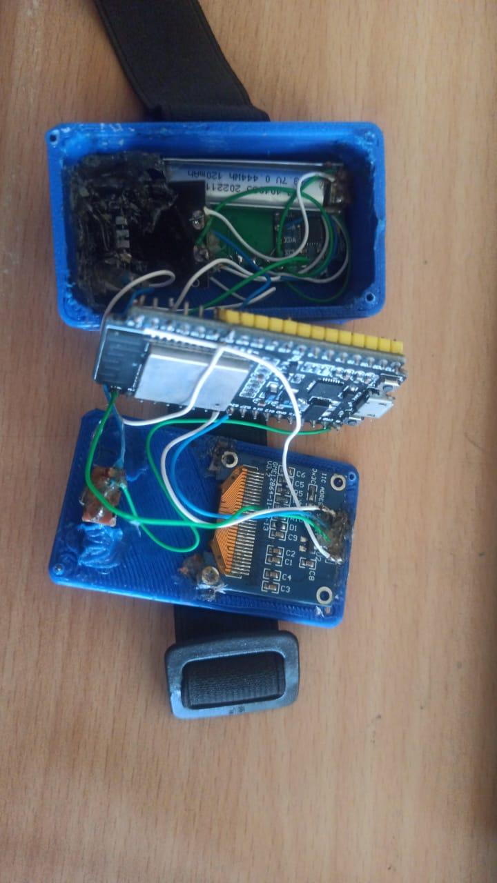

Step 2: Setting Up the Hardware
Circuit Connections:
Connect the components to the ESP32 according to this pinout:
OLED display:
  1. VCC → 3.3V
  2. GND → GND
  3. SCL → GPIO 22
  4. SDA → GPIO 21
MPU6050 Connection:
  1. VCC → 3.3V
  2. GND → GND
  3. SCL → GPIO 22
  4. SDA → GPIO 21
MAX30102 Connection:
  1. VIN → 3.3V
  2. GND → GND
  3. SCL → GPIO 22
  4. SDA → GPIO 21
Battery Connection:
  1. Connect to the battery charging module
  2. Connect battery + to ESP32 VIN through the charging module
  3. Connect battery - to ESP32 GND

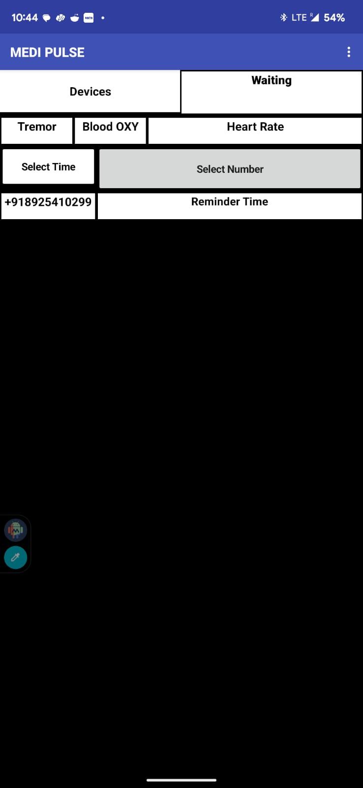

Step 3: Creating the Mobile App With MIT App Inventor
I created a custom mobile app using MIT App Inventor to interface with the ESP32 via Bluetooth.
The app displays real-time heart rate, SpO₂ levels, tremor alerts, sends medication reminders, and includes an emergency call option for quick access during critical situations.

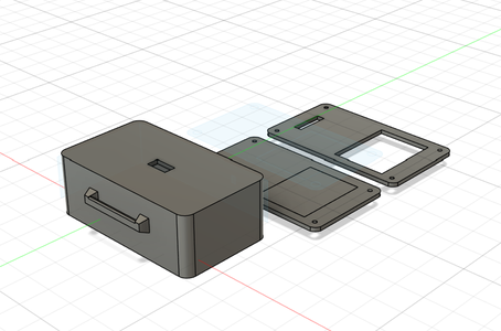

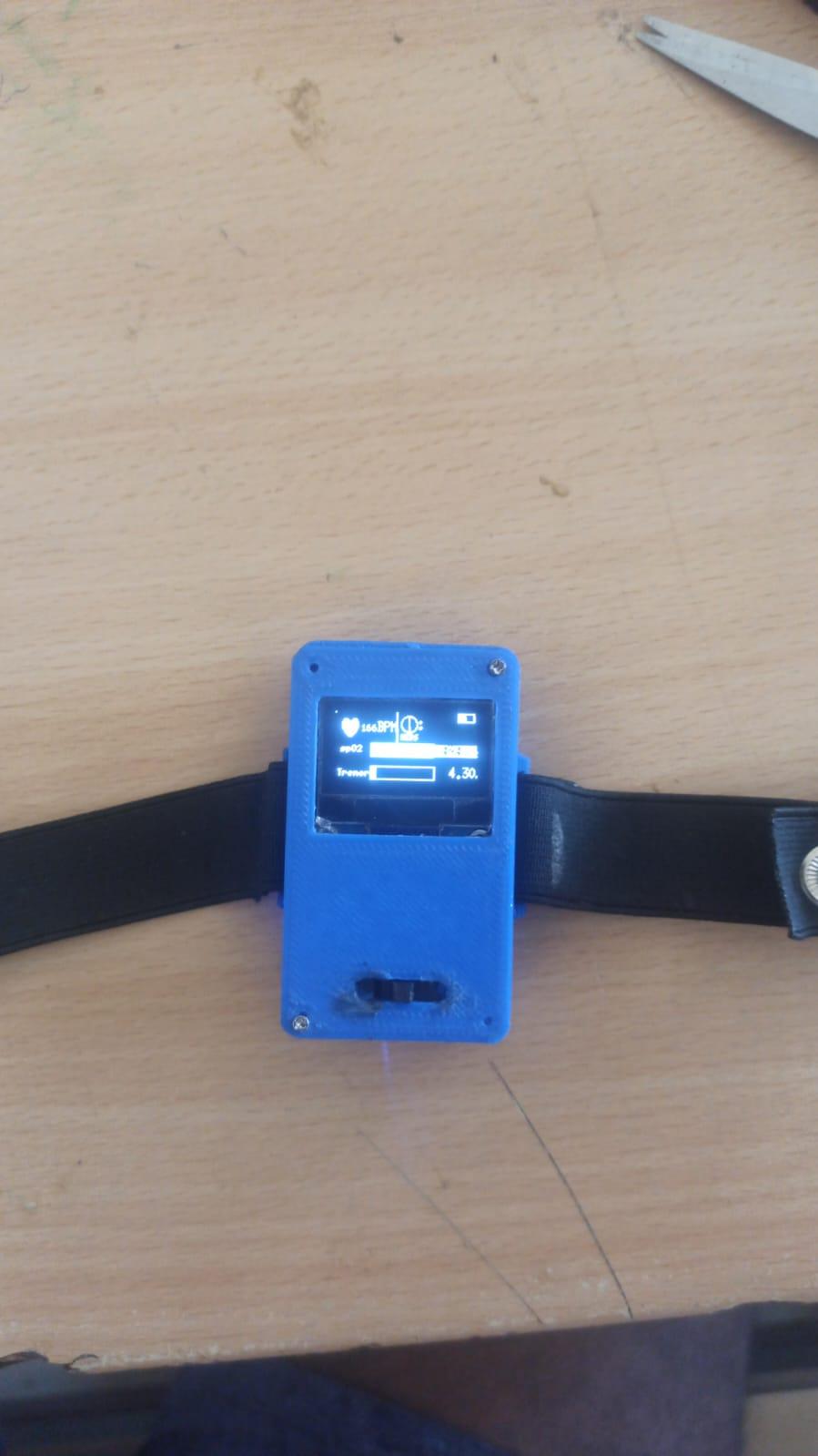

Step 4: Creating the Enclosure
I designed a custom enclosure for the device using Autodesk Fusion 360.
The design keeps the ESP32, MAX30102, MPU6050, and battery securely in place, with openings for the sensors and access to buttons.
The case was printed in PLA with a 0.2 mm layer height and 20% infill.
After printing, I assembled the components inside, ensuring proper alignment and easy access for charging and maintenance.
