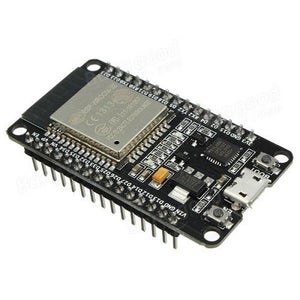

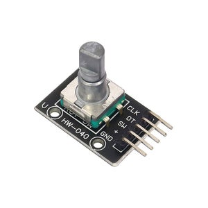

Hardware parts:
ESP32 DOITDEVKIT V1 : https://a.co/d/7rwitrc
KY 040 Rotary Encoder: https://a.co/d/6ejCpry
some wires
NOTE: Please buy exactly these parts, it can be from any site, for reference I have given the amazon links.

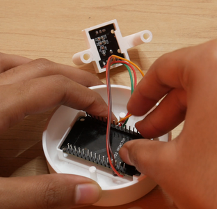

Step 1: Connect the Hardware
Refer the circuit diagram provided and make the connections on the rotary encoder and esp32.
NOTE: Solder the rotary encoder first, insert the other end of the unsoldered wires through the encoder_holder.stl part (as shown in the video). Then solder to the pins of the esp32.
Step 2: Test the Connections
Once the code has been uploaded test the working of the device by connecting it using bluetooth on your PC.
The default name is ESP32 knob.
Once it has paired and connected, rotate the encoder to observe change in volume or push the encoder switch to see if it pauses/plays the song.

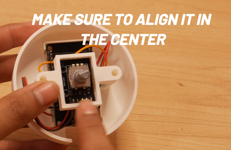

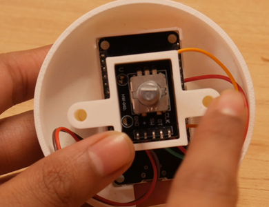

Step 5: Assemble the Parts
Before applying hot glue assemble as shown in the images to check the alignment of the rotary encoder part.
As you can see in the third image, the rod of the encoder is not exactly in the centre. Simply rotate it 180 degrees and it will be in the centre.

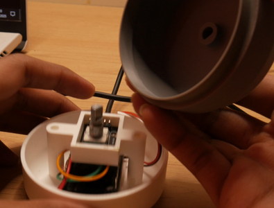

Step 6: Apply Hotglue and Finish Assembling
As shown in the first image, make sure the esp32 power/microusb port is facing towards the gap I have given in the part.

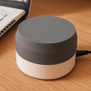

Finally power it using a microusb Cable, and thats it!
Step 7: Thats It!
Do check out the video, to know how to use all the features.
