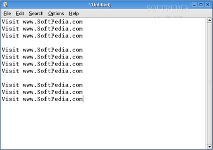

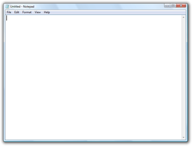

this step is somewhat simple. you simply need to have a simple text editor on your computer like Notepad, or, in my case, as i use Xubuntu (pretty much exclusively for my day to day computing, including surfing, video editing, downloading, and chatting, etc) Leafpad.
the file needs to be named SMS.smb (do not ignore the capitals). the contents of the file are:

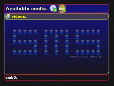

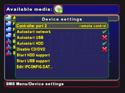

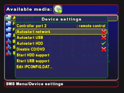

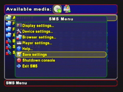

open Simple Media System (this uses X for Enter and triangle to cancel/go back). hit start. go to Device Settings, then make sure that Autostart Network is turned off. Hit Triangle to exit, then go to Save Settings and Hit X. after this exit SMS and then re-enter it. Hit Start again and then hit Device Settings again. after this, you should see a new network protocol on the bottom (SMB/CIFS). Go to Start Network Support and hit X. then scroll down to the Network Protocol and hit X to ensure that the new Network Protocol is selected (SMB/CIFS). after this is selected, wait a few seconds for the network to initialize, and a new icon should pop up on top (a Windows Icon with a hard drive behind it). After this, make sure Autostart Network is turned on. Then Hit Triangle to exit this and go to the main Start Menu, scroll down to Save Settings, and hit X to save them. Happy Viewing!!!
