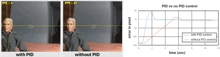

The initial test is performed without PID control. Tracking is achieved by adjusting the camera's position in fixed fractions of a degree until the center of the face aligns with the offset zone. Two scenarios were compared: one with a 0.3-degree increment and the other with a 0.4-degree increment. The graph illustrates that with a 0.4-degree increment, the camera moves quickly, but it also exhibits oscillations around the offset box without coming to a stable position.
Step 4: With PID Control
In the application of PID control, optimizing the values of Kp, Ki, and Kd is crucial. In this particular case, it appears that Ki and Kd have less impact on the movement. Comparing the results to the scenario without PID control, depicted in the graph and image, it's evident that the face swiftly reaches the offset box (referred to as the setpoint in PID terminology).
