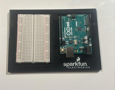

Step 1: Set Up the SparkFun Board
Get out your Breadboard and Arduino set up like this:

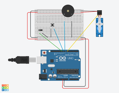

Step 2: Wiring
Here’s a digital example of what the board will look like made in Tinker cad. Use this as a reference for your physical board.

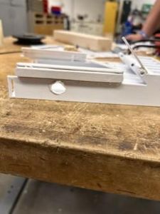

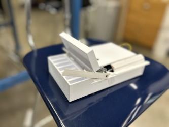

Step 4: Begin Box Assembly
  1. Print CAD Pieces
  2. Align top lid with main box hinges
  3. Insert hinge rod into lid holes
  4. Cut open top of main box (this allows room for the board to sit inside)
  5. Add small platform to catch lid

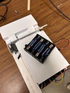

  6. Add supports and tape down servo motor and add a lever to open the lid
  7. Add levels on either side of the box openings and insert Arduino board
  8. Drill hole in side for battery pack
  9. Drill hole into top of the cut off part of the box and attach to the levels
  10. Insert battery pack
That's it!

Step 6: Showcase Your Project!
After everything is set up, this is how your box should function. Feel free to change the color of the box, add decorations, or anything else to customize it to your heart's desire!
