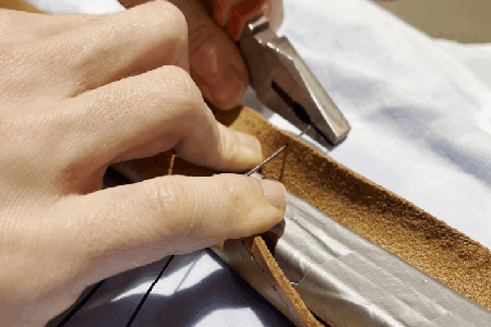

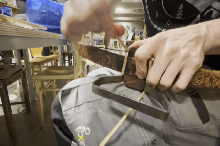

Step 1: 🏹 Building the Bow
I started by cutting a plywood piece and sanding it to a lens shape. This served as the backbone of the bow. Then I took three fiberglass rods — two full-length and one split in half — and secured them to the plywood using PowerTape. That held everything in place nicely for the next step: the leather wrap.
To wrap it, I did this neat trick — covered the whole bow in PowerTape, then carefully sliced it off in one piece. Boom, instant template. I stuck that tape template onto my 2mm cow leather and cut it out perfectly. Next, I printed a floral pattern and transferred it onto the damp leather by tracing it with an old pen. Then I cut the marks with a swivel knife, and stamped it with Tandy tools. The leather got stitched over the fiberglass core, with the ends glued shut like caps. It looks and feels super authentic — very Kingdom Come vibe.

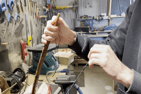

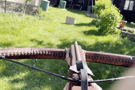

Step 2: 🎯 Stringing It Up
The string situation was a journey. I first tried the ol’ “bend-it-around-your-leg” bow trick — didn’t work; the bow’s too short and stiff for that. Tried clamps next, no dice — the bow slipped everywhere. Final boss move? Opened up my vise, bent the bow right over it, and strung it while it was flexed. After installing the string, the bow stayed bent, giving it that proper tension.
I used a store-bought Dacron crossbow string, but it was too long out of the package. So I tied a knot on each end until it fit right — not fancy, but it worked perfectly.

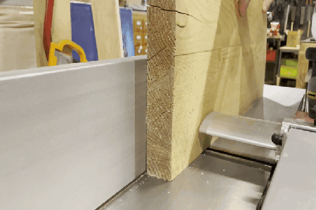

Step 3: 🪵Shaping the Body
The body of this crossbow was carved from a spruce wood beam and shaped. The final form is compact, smooth, and clean — perfect for slinging foam darts at friends or just showing off your craftsmanship.
The process started by trimming the beam down to size using a table saw and making it smooth using a planer. From there, I sketched out the general body shape and cut it with a bandsaw.

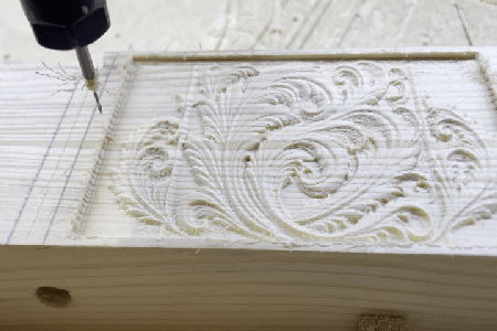

Step 5: 🤖 Carved by AI – CNC & Motif Design
This crossbow isn’t just functional — it’s a piece of art, too. One of the highlights of the build is the floral motif that runs along both sides of the body, carved deep into the wood using CNC. It adds a custom, medieval flourish that really sets the whole thing apart.
🤖 From Prompt to Pattern
To generate the motif, I used DALL·E with a prompt for a “monochromatic top-down view of a floral motif” — something that would evoke historical carvings but still have a unique feel. Once I had the image, I ran it through an AI heightmap generator using tangram height mapper (or a similar tool) to create a usable depth reference.
From there, I converted the heightmap into a 3D mesh using Image to stl — a handy online tool that transforms images into STL models based on brightness values. The result looked great, but it was a little too complex for Fusion 360 to handle smoothly.
So I ran the file through Meshmixer to reduce the polygon count without ruining the detail. Once that was cleaned up, I brought it into Fusion 360, used the built-in CAM tools to generate G-code, and got ready to cut.
🛠 Carving Process
The wood was spruce — soft, easy to cut, and it held detail really well. I used a 1mm round carving bit and set the depth to 3mm for a solid visual impact. It took about an hour and a half per side to run the toolpath.
Funny enough, the wood formed thin, curly strings that wrapped around the carving bit. Instead of clogging it, though, they acted like a mini fan and blew the sawdust away — a weird little bonus.
At first, I tried carving the design with a 3mm bit, but it looked too clunky. Switching to the 1mm bit made all the difference.
🧷 Setup & Securing
To keep the piece stable, I used both screws and double-sided tape. The screws with washers run through the holes I already made for other features. I also ran a test on a sacrificial piece before cutting the real deal — no second chances with an hour-plus carve time. My Z-probe was busted, so I zeroed the bit manually. Old-school, but it worked fine.
Surprisingly, everything just worked. From image generation to carving, the whole pipeline ran smoothly. If you’ve got access to a CNC and want to bring some AI-generated flair to your build, I highly recommend giving this method a shot.

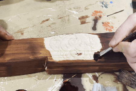

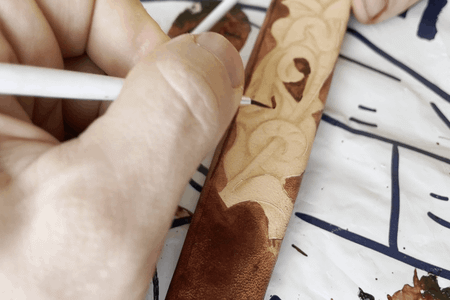

Step 7: 🎨 Dyeing
With the build complete, it was time to give the crossbow its final personality — and honestly, this part took it from “homemade weapon” to “display-worthy heirloom.”
🎨 Dyeing the Details
I used an ethanol-based wood dye, applied in multiple coats. For the CNC-carved floral designs, I started by dyeing the recessed areas first — basically flooding the valleys to darken them. Once that dried, I dyed the entire surface, and then lightly sanded the top layer. That sanding brought back the natural wood color on the raised parts, creating a super satisfying contrast that made the carvings pop.
I used the same dye on the leather, but only in the stamped recesses. Then I went over the carving with a specialized highlighting paint, which added depth and really brought out the stamped floral design. No overkill — just enough to give the surface that lived-in, authentic feel.
🪵 Surface Finish
I kept the wood finish matte to stay true to the medieval vibe. I’m still considering adding a layer of oil for durability and a bit of richness, but even bare, it looks and feels great. The surface has that soft, touchable texture that you get from good sanding.

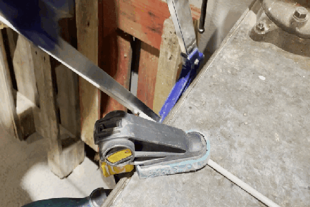

Step 8: 🔥Stirrup, Dart Holder and Forging Trial
While the crossbow’s heart is wood and leather, the metal components are what make it truly usable. This chapter covers the small but mighty parts — the foot stirrup for cocking, and the dart clip to keep your ammo locked and loaded.
🦶 Foot Stirrup
I made the stirrup from a steel strip (2×6×1000 mm) bought at the local hardware store. At first, I tried to freestyle the bends in a vice using a hammer, comparing it to a technical drawing — but yeah, that turned into a mess. The angles and radii were totally off.
So I switched gears and got precise: I marked both the steel strip and the vice jaws so I could match each bend point exactly and mirror both sides. Then I slipped a box-end wrench over the steel and used it as a bending lever — way smoother and way more accurate.
Once it had the right shape, I drilled holes in the ends and screwed it directly into the front of the crossbow body. Simple, sturdy, and functional.

Step 9: 🪢 Mounting the Bow
The body of the crossbow has an angled notch carved into it so the bow slides in snugly. I passed a leather strap through a hole in the body and tied it around the bow in classic medieval style. Holds strong, looks rad.

🧪 Field Testing
I tested it in the yard with my son, firing simple darts made from beech dowels and leather fletching. The shots are clean and accurate for something made mostly in yolo fashion. The trigger's a little stiff, but that actually turned out to be a good thing — no accidental shots, even with kids around.
