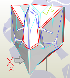

If you take a look at this section of the helmet in Pepakura’s 3D view, you’ll notice that half of it is gray and half is white. The white section is facing out, while the gray section is facing in.
This happens because Blender incorrectly calculated the normals. If you don’t know what that means—it’s basically the orientation of a surface (whether it’s facing outward or inward).

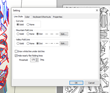

It’s not really Blender’s fault—this was on me. I was supposed to check the face orientations, but I didn’t know that at the time. Because of this, some pieces ended up with the wrong fold lines.
To fix it, I reversed the fold types for valley folds and mountain folds. I then exported two PDFs and replaced the parts with incorrect fold lines using www.photopea.com. Now the problem is fixed.

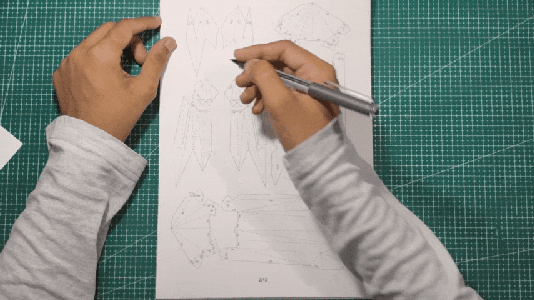

After printing, I moved on to marking and labeling the pieces. I assigned each piece a part number and grouped them according to their section of the model. This organization made it much easier to locate pieces during assembly.
Since I had divided the helmet into separate sections earlier, some edges were missing flaps. So, I marked the edges that would need flaps added later.

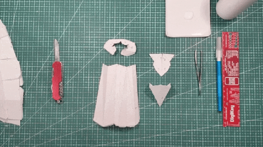

Now, the paper I used is pretty heavy—300 gsm—which looks great in the end but makes clean folds nearly impossible. To fix that, I had to score every fold line using an X-Acto knife. The trick is to press just enough so the blade doesn’t cut all the way through but still lets the paper bend crisply.
One more problem with thick paper, glued seams stick out like sore thumbs. To counteract this, I removed a thin layer of the paper from the flaps to make them thinner this makes the seams hard to notice . Now all the pieces are ready to be glued together.

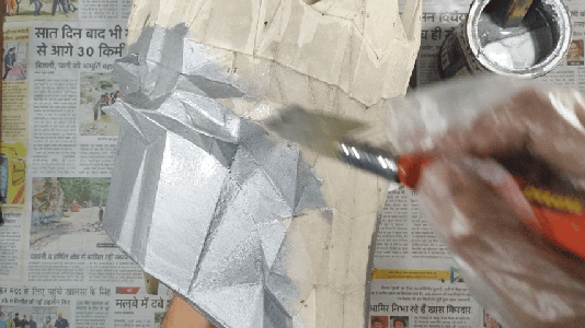

This is the part that makes or breaks this project. My plan was to make the helmet look like it is made of old steel, like it was found in a dungeon. To achieve this look, I had to apply multiple layers of paint, starting with a base coat of metallic oil paint. This layer works as a simple base color and also will make the above layers look shiny. After letting it dry, I applied a second coat to cover up any spots left.

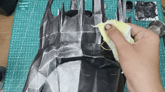

To achieve the old look, I used a unique painting method. First, I coated a section with watered-down black acrylic color. After it had partially dried, I used a dry sponge to remove the wet paint and repeated this process again and again. This gave the helmet a weathered look, but now the silver is barely visible, and the helmet just looks black. To fix that, I took a piece of dry cloth and rubbed it on the edges of the helmet. This removes some of the black paint, revealing the silver color underneath. This can also be observed in some ancient helmets since if a helmet has sharp edges like mine, it tends to get damaged and scratched on the edges easily.
