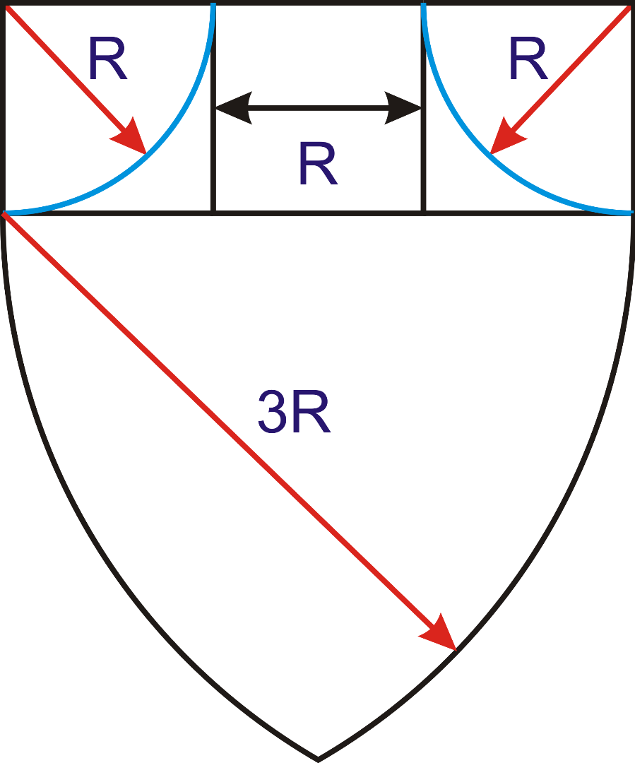

Step 2: Measure and Draw
Generally for a heater shield, the proportions are as illustrated in the first image, but I wasn't a fan of how it would look with those proportions, so I made my shield slightly taller. The proportions you pick are up to you.
I had already printed out a canvas at the size that I wanted, so I just needed to draw out that size on the plywood.
It is important to trace out where you will be cutting before bending the wood as it would be significantly harder to do so afterwards.
My shield measured 23" across the top, with an 11" vertical section, then 23" radius arcs on both sides, intersecting at a point to give you your traditional heater shield shape. This makes the total length of the shield about 32". To make the soaking/bending process easier, I went ahead and cut the plywood to be 35" long instead of 48".
