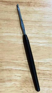

  2. Crochet hook (I used 3.75mm)

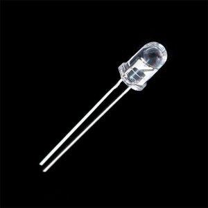

  3. 4 LEDs

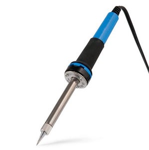

  4. Solder

Firstly, I curled the legs of the LEDs into small hoops. This will be useful when it comes to sewing the legs onto the crocheted wristband.
Next, I soldered the LED legs with wires.
