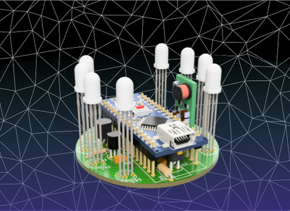

Step 3: Designing the Circuit
We are going to control 8 LEDs and each channel is roughly going to consume 10mA of current so for 8 LEDs it will be 80mA which our microcontroller's (Arduino Nano) GPIO can't handle directly so we will control the LEDs with a BJT (Bipolar Junction Transistor).
To get the user input I have chosen a touch sensor(TTP223) so the device has a clean look (as we are focusing minimizing the distractions).
To get a subtle identification of the touch button press we can add a buzzer(optional).
The whole circuitry will be powered by a 500mAh Lipo Battery so a charging and protection circuit(TP4056) is used and a switch to turn on and off the device. and as the RGB LEDs have a forward voltage drop of around 2.5V we need at least 3.5v Power Lines so we can't rely on lipo solely as it can vary from 4.2v to 2.8v so we have to include a DC-DC boost converter to convert lipo voltage to usable 5V.

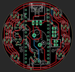

Step 4: PCB
Now we have designed the circuit, it now time to create a PCB, and for that, I have used Eagle CAD.
As I have used a diffusion cover of an LED Bulb with a bottom diameter of 48mm, I had created a PCB of the circular dimension of 48mm to fir flush with it.
Then I have used the Fusion 360 Sync feature of Eagle CAD to build a casing around the PCB.
If you don't want to fabricate PCB yourself, then you can go for solutions like JLCPCB, PCBWay, NextPCB, etc., where you can upload the Gerber files (which you can get from this link), and you will get PCB a week or two.
If you are going this way, then skips the steps ahead to go directly to step number 8.

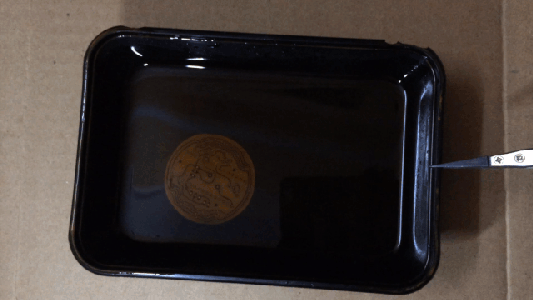

Step 7: PCB Etching & Drilling
Now that you have the traces transferred to the copper-clad, we can move forward for etching the PCB so only the copper under the traces remains on the clad, and rest of the copper gets etched away.
We will be using FeCl3 (Ferric Chloride) for the etching process.
It will take around 5-10 minutes for the etching process to complete. (it is recommended to agitate the etching solution during the process to speed it up).
Afte the etching is completely clean the PCB with acetone and drill the holes.
Note: use a 0.8mm drill bit for all the holes except the one for mounting the PCB on the cover, it is 2mm.
Step 8: Soldering the Components
Now we have a PCB and we can move forward to solder all the components at their respective place, take the reference from the design to find which component will go where, or see the images above to find the relative position of the component,
Just for reference, we have used Common Anode RGB LED and its notch is on the inner side of the PCB.

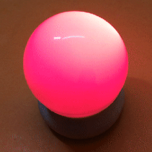

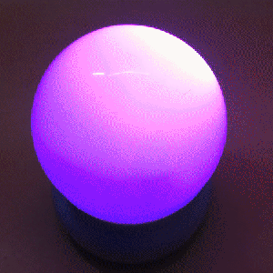

Step 15: Working of the Device
As you turn on the device, you will see the glowing and fading of the last chosen color according to the 4-7-8 timing rule.
To change the color, you need to long-press on the touch sensor (if you struggle to find the touch sensor on the body, it is just opposite the charging port). For the long-press, it will automatically beep.
For pausing on any color, whether in color choosing mode or the normal glow/fade mode, just a single tap on the sensor.
As soon as you choose a color from the color choosing mode, it gets saved in the memory so that you can enjoy it after restarting the device

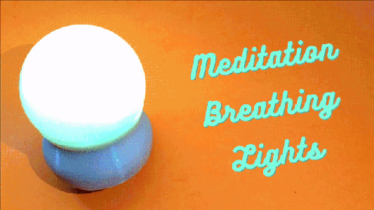

Step 16: Now Enjoy a Peaceful Breathing Session
It time to sit back relax and enjoy rejuvenating breathing sessions with your own little meditation lights.
Also, you can use it as a mini mood lamp on the study table.
