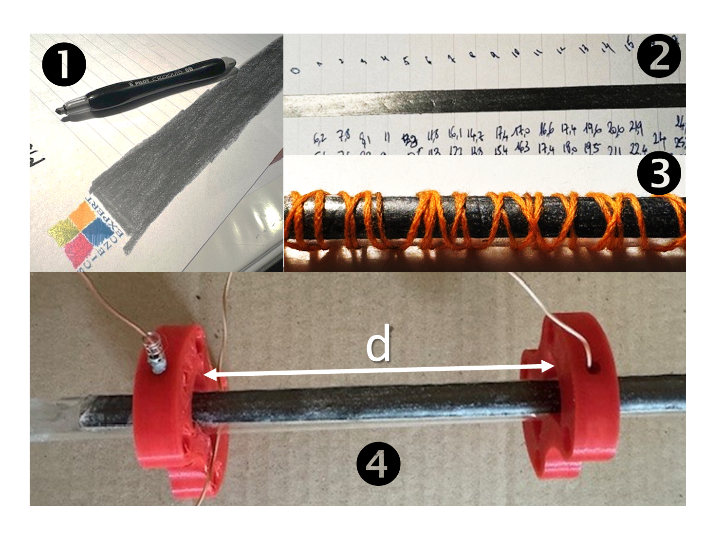

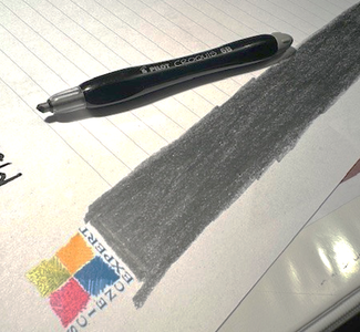

First we draw a black stripe on the paper with the 6B pencil at the desired distance. Several passes are necessary to achieve sufficient conductivity (picture 1). A 1 cm strip is cut with a cutting machine. This strip can be used to make initial measurements and validate the concept (picture 2). The strip is then positioned on the final support. This is a polypropylene tube. The conductive tape is fixed by means of adhesive and is held in place during the setting time by means of a woollen thread (picture 3). The final assembly, with two connectors separated by a distance (d), makes it possible to measure the resistance obtained (picture 4).

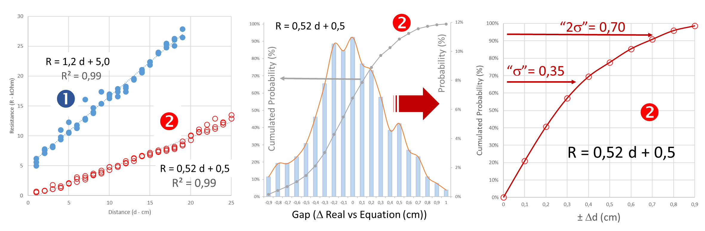

We carried out two tests to validate the concept and assess the accuracy of this sensor. In the first test (number 1 in blue in the graph below) we did not use a lot of pencil deposit, making only two passes. In the second (number 2 in red in the graph below), we forced the amount of pencil deposited by making at least 4 passes. Resistivity measurements have been made randomly three times per distance.
In both cases there is a linear relationship between the distance (d) and the resistance. The slope of the linear equation between distance and resistance depends on the amount of graphite deposited. The higher the graphite deposit, the lower the slope : 1.2 in the first case, 0.52 in the second.
In the second case, we are continuing the investigation. This will enable us to assess the accuracy of this sensor. To do this, we studied the probability distribution of the gap, which is the difference between the measured resistance and the theoretical value given by the equation.
These gaps are representative of the error due to variation in the amount of graphite deposited and the error in the measurement of the distance (d). The gap distribution is not a Gaussian distribution. Alternatively, the cumulative probability for the gap value (±d) gives a fairly good assessment of the probability of being 68% or 95% confident (similar to 1 standard deviation and twice the standard deviation for a Gaussian distribution).
The distance is assessed at the interval of +0.35 cm for a confidence level of 68%. The distance is assessed at the interval of +0.70 cm for a confidence level of 95%. In fact, 68% is more than enough for this sensor, and the higher the distance measurement, the higher the accuracy, thanks to a fixed inaccuracy of 0.35 cm.
