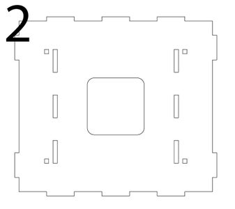

- In the zip file that you downloaded earlier, navigate to the Common Laser Files folder and find the Lower Block Mesh Outline files. All of the laser files come in .ai, .svg, .dxf, and .pdf. Select the one that you prefer and cut it out of acrylic.
- Use the Lower Block Mesh Outline piece of acrylic to trace cut lines onto the 0.35 mm hole steel mesh with a pencil. Cut out the mesh along the lines with a pair of scissors.

Step 12: Outworld Assembly I: Mesh Window and Weld-on
- Cut a 60 mm x 60 mm piece of the 0.35 mm mesh.
- Find the piece of acrylic that looks like photo 2.
- Gather two sheets of wax paper, a flat piece of scrap acrylic or wood, and a heavy object.
- Put a piece of wax paper down on a flat surface and then put the acrylic piece on top.
- Spread a thin layer of clear Gorilla Glue around the rectangular hole in the center as shown in photo 3. It's ok to be messy with the glue because it will be covered by hydrostone in a later step.
- Put the mesh over the glue, and press it down. See photo 4.
- Cover the mesh and glue with the second sheet of wax paper and then put the flat scrap on top. See photo 5.
- Put the heavy object over the scrap and let everything sit for at least an hour. See photo 6.
- After an hour, take everything off of the piece. It should look like photo 7. If the mesh isn't sufficiently glued in place, add another thin layer of gorilla glue to the mesh where it's loose.
