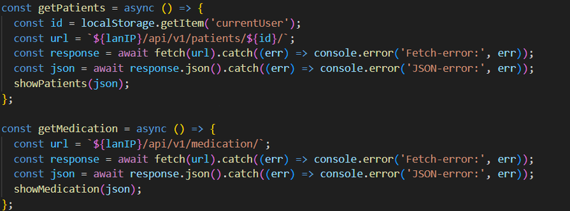

app.js
1. Real-Time Communication
  1. Uses Socket.IO to connect to a backend server for live updates (e.g., time changes, RFID login/logout, container detection).
2. User Authentication and Session Management
  1. Handles caretaker login/logout using RFID and manages session data in localStorage.
3. Patient and Caretaker Display
  1. Fetches and displays the current caretaker’s name.
  2. Retrieves and lists all patients assigned to the logged-in caretaker, including details like name, age, gender, room, next medication time, and delay status (late or early).
4. Patient Details and Medication
  1. Shows detailed information about a selected patient (name, gender, address, age, room).
  2. Fetches and displays the patient’s prescribed medications, including dosage and scheduled times.
5. Medication History
  1. Retrieves and displays the medication intake history for patients, allowing caretakers to check off if medication was taken.
6. Medication List
  1. Lists all available medications and their purposes, with options to edit entries.
7. Hardware Integration
  1. Reacts to hardware events, such as:
  2. Detecting if a medication container is present (distance sensor).
  3. Updating the UI based on container status.
8. Adding New Patients
  1. Provides a form for caretakers to admit new patients, sending the data to the backend API.
9. UI Interactivity
  1. Dynamically updates UI elements based on data from the backend and hardware events.
  2. Enables or disables buttons based on medication selection.
10. Modular Initialization
  1. Runs different logic depending on the current page (login, home, patient detail, history, medication list, add patient).
